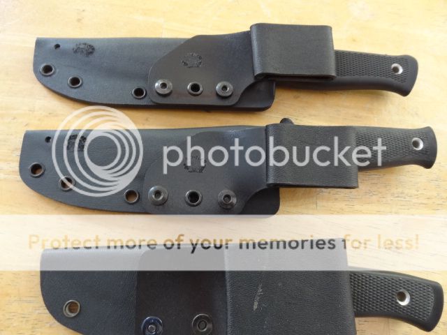

Those were done by a maker here on the forum. It gets hot as hell down here and I wear a lot of shorts with elastic waist bands and no belt. They have a very tight snap and are very secure. Once they are on its a done deal. They really opened up my carry options.
I use the Esee 5/6 clip plate as well. I have them on about five knives. Will get more for any new blades. For smaller knives that don't need to be drop down the Esee 3/4 clip or izula clip might work. I carry the izula horizontal a lot.
