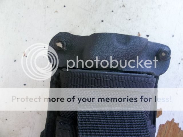

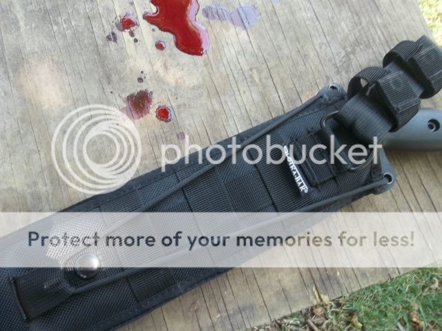

So I like the 4 sheath, as I mentioned in my review thread, but I dont care for handle snaps. So I went and made a kydex/nylon hybrid out of it it. I love it just from a few minutes of using it.
Enuff of my drivel, on to pics!

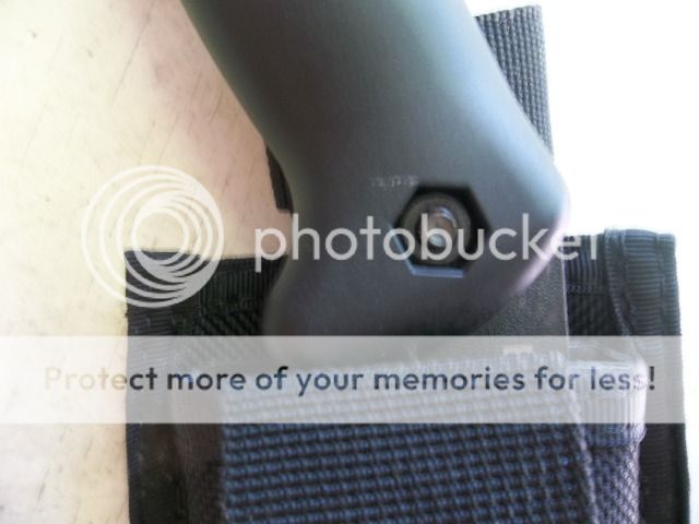

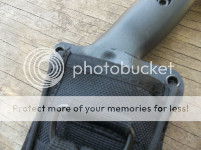

Before

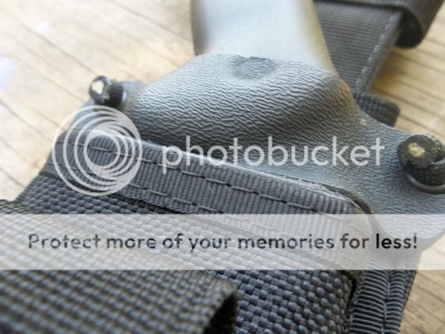

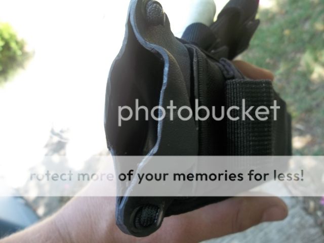

After
It still needs to be polished and final-sanded...but the function is perfect, I am pleased.

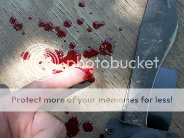

When working with a shaving sharp machax...and using a open kydex ''sheath'' keep ur fingers off the blade! I made a slight error and sunk the 4 to the bone. A lil pressure, gauze and tape...and I managed to finish it up.

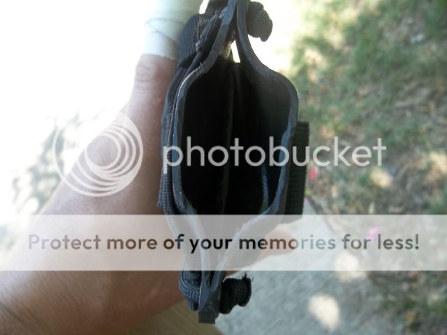

The Tee section of the kydex slides down between the sheath and the sheath's blade liner.

That is a real slick idea there Clayton. I like my Machax sheath a lot, and I don't mind the snaps too much. But I don't like how the handle slides up exposing about 1/2 inch of edge. Your invention looks like would also stop that problem as well. :thumbup:
Heck of a setup you got there man. Very nicely done! :thumbup:
