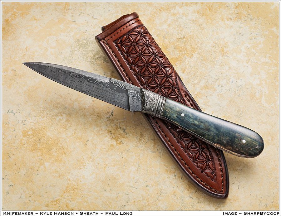

Kyle has gotten a bit tired of the simpler knives, so he made this one.
He's liking the bolstered look and is chicken eying my fossil ivory stash. :o

I did not realize it was possible to epoxy bolsters on to the blade. Please explain.

The bolsters have two hidden pins that go through the tang and partially into each bolster, press fit. Also LocTite 324 glue is used. They will not come off...

I haven't ever tried press-fit pins. There is the whole surface area of the bolster-tang interface for the glue to hold, and the surface area of the pin-bolster interface. Is there a mechanical bond that is very strong between the pins and the bolsters other than the glue, or is it just that this much surface area, complete with pins to prevent shearing, keeps everything in place?

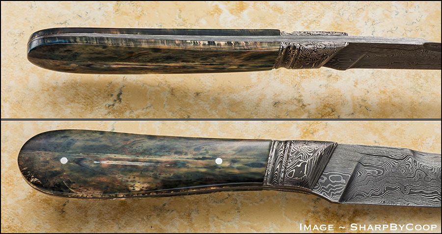

Interesting Damascus pattern, looks as though the pattern varies a bit from side to side.

The pins and glue work together, but the glue is more of a sealer than for strength.
The blade is 4.5" and 9" over all.

Wow-I like this one a lot...for several reasons. I was wondering about the Damascus bolsters, too-glad I wasn't the only one scratching my head ;). Hoping you'll put up with one more question....? I'm assuming the pins go through the tang and each bolster shares the same pin and is pressed on? If so, is the pin slightly looser in the tang so as not to mushroom one side trying to get it in? Pretty cool idea whatever the specifics and makes me appreciate the various challenges and precision needed to pull it all off. Great knife....
