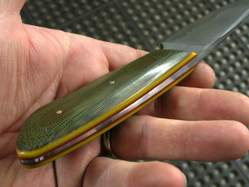

Kyle is knocking em out lately. This one turn out pretty good. :cool:
W2 at 62 Rc, Smokin Hamon, Fossil Mustard & Green Canvas Micarta.
Got to see this one today. Awesome piece. Love Kyle's use of the micarta. Nice feel in hand. I think it went to a lucky owner this evening. :thumbup:

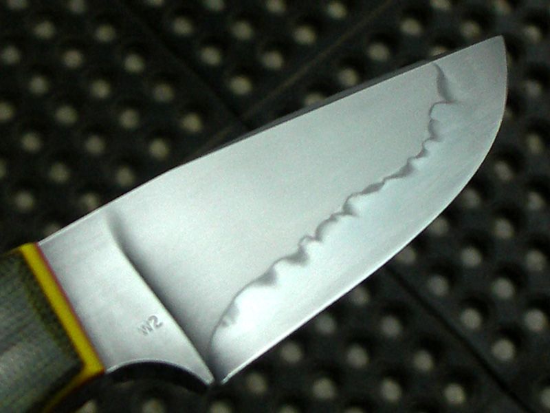

You guys know W2 heat treating back to front and upside down , I'm still working on it using some of your figures so thank for putting the info out there . The question I have is how can you know this blade is exactly 62 RC , or close there a bouts, when you can't Rockwell test an edge on an edge quenched or clay deferentially treated blade ? Have you done smaller samples and tested them and use the same heat treat formula that you know produces the goods , or do you have some way to test this actually edge that is more accurately than test files. I'm using test pieces my self.
Good question about the Rc hardness. We only test flat parallel surfaces & test pieces. We use the same heat treat recipe for this W2 and this W2 is Very consistent. Many sample pieces done and I check all folder blades at the tang. Rc hardness will vary no more than a half a point. Thanks.
Thanks Don , that's what I thought you would be doing. That's pretty much what I have been doing to get it right.
Cheers Adam.
Have I missed something? How can one go about doing an hamon like this on a knife? (I have a hard time seeing me accomplishing that with mustard etching?)
