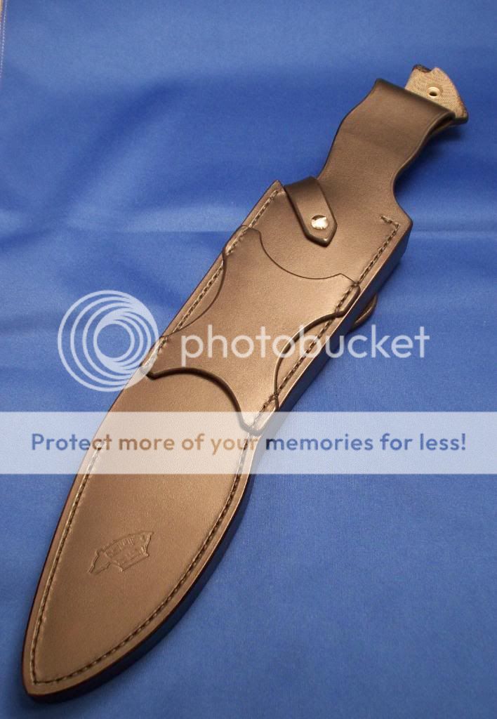

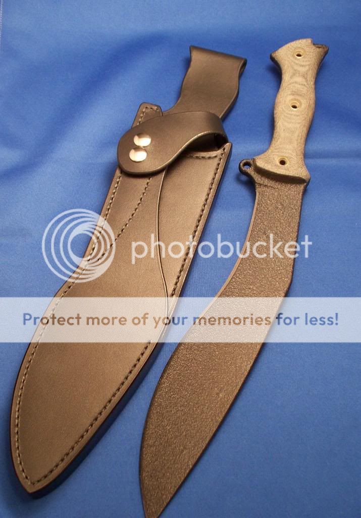

I managed to make myself a KZII sheath today. I was suprised at how much different the KZII is compared to the TTKZ.
This sheath was made to hold the knife even if the snaps are undone. I used RE magnets and welt retention (On the talon Hole), I even managed to get the angles just right so that the scales aid in holding the knife in.
Well on to the pics. :D

The awl should work fine. Just make sure it is sharp and lube it with beeswax now and then while you are working. Either that or buy a dremel drill press and make your life easy.
