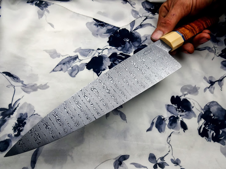

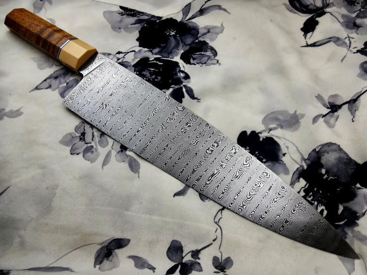

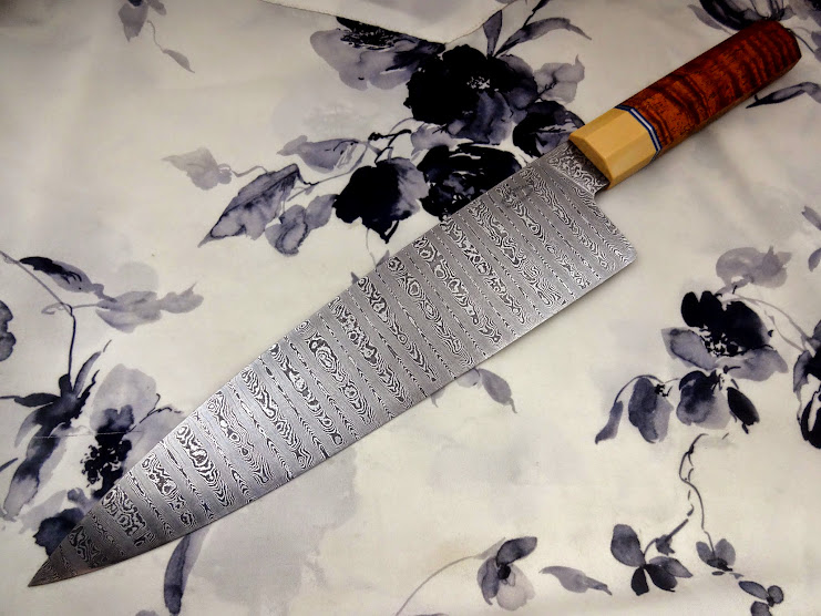

This is the latest knife I’ve finished- a 9-1/2” chef knife with a “wa” style handle. The handle features an ivory micarta bolster (Ken Coats came through for me, gave me a chunk of this great stuff through the mail when he found out I needed just a little bit, ASAP) and oddly enough a block of nice curly Kiawe wood from Hawaii that was given to me by the generous Mark Farley. Spacers are 410 SS and blue G10. Since the handle and bolster materials were given to me, I think it fitting that this knife will be a gift as well- from me to my wife for her birthday next week.

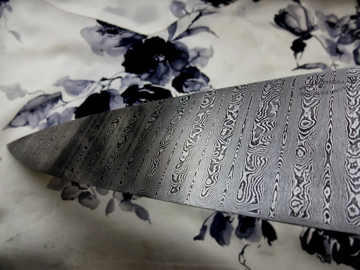

The blade is some Damascus I made up of CruForgeV and 15N20. This is the first time I’ve made dammy with CruForge, I must say it’s a pleasure to work with although it makes sanding a bit tougher. It should cut like a demon though. The billet was taken to 171 layers, profile forged and laddered by grinding. It has a really nice chatoyance when played around in the light, I tried to capture just a little bit of that in the last pic.
The blade is 9-1/2” in length, with overall length at 14”. Total weight is 7.25 oz. The spine is .100” thick at the ricasso, with long distal taper. The edge is at .010” before sharpening. The blade is 2-1/4” tall at the heel and features a full flat grind.
That’s enough chatter, here’s pics. Hope you like it!

Thanks guys! I was really pleased myself with the pattern on this knife, it was hard to forge the billet wide and thin enough after laddering.
