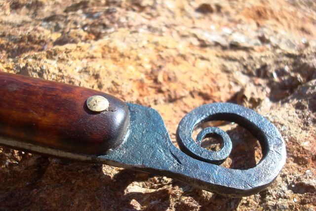

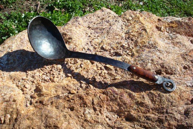

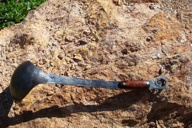

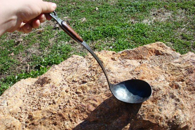

Made this up last week, forged from mild steel, with offset curl on tail for hanging, and curly maple hndle w/ brass pins.
Little over 13" long, with nice big extra deep bowl for those extra big servings of chili
