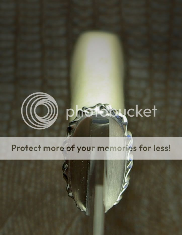

This was a concept knife, wanted to try leaving a fileworked spacer proud of the rest of the handle. The double grind was a stretch for me as well as my first tinkering with ivory. Be interested to hear what you guys think, thanks for looking.
-Haley
1084
Blade - 3 1/4" X 7/8"
OAL - 7 1/4"
Handle - Ivory
Fittiings - Stainless

It is a very clean, nicely ground knife....you are turning into a heck of an accomplished maker....that's really nice to see.
IMO, the longer handle and shorter blade make it look unbalanced....I always try to get makers to go AT least as long with the blade as with the handle. Would have liked to see a bit of tapering and possibly a groove in the handle to help the fingers keep from slipping on that slick ivory.

I think anytime you set out to create an easily concealable or compact knife with around a 3" blade a slightly unbalanced look kind of goes with the territory as opposed to being a defect. You are kind of limited as how short can you make a handle yet still have a perfered degree of comfort and/or functionality.
I love your blade profile/grinds and feel the fileworked spacer adds a nice decorative touch. Is the clip sharpened?
I agree 100% with Steven in that a little shaping/tapering of the ivory would have really taken this piece OVER the top even though It's a very nice piece now.

Thanks so much for the encouragement and ideas guys...living out like we do we don't have many people to show our work to and get feedback. It's always appreciated.
I know what you mean STeven...the handle is just long enough for the 'spider butt' swell of the handle to fit in the hollow of your palm...but just think, when TSA goes back to the 4" blade rule you could take it on the plane! :thumbup:
Kevin, no the clip is not sharpened and yes...I agonized over this handle because I had intended to make it far more slenderized and curvier but the ivory just didn't have it...it would have been solid tapioca showing had I gone any further, awwell. The rope filework sticks above the handle just over a 16th of an inch and that gives it quite a bit of grip actually...you can see it better here. Quick pic, forgive the fuzzles:o
