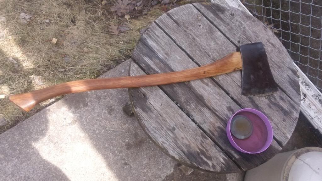

I don't believe laminations have to be stiff or unfeeling. The limbs of recurve bows are always laminated. Even in ancient days, it was so.
I think it would be a good way of making an S shaped haft, if you can't find a length with suitable grain. I don't see any benefit for a straight haft.
Epoxy is great for laminating.
An offset handle like the one pictured is fine for a hewing ax but for splitting or trimming on both sides, symmetry is advantageous.
I was thinking of this bend, not an offset.
http://i201.photobucket.com/albums/aa136/Mindokwin/DSC00790_zpse1fe22e7.jpg
I haven't done so myself, but sometimes it takes a month to buy a decent haft in a local store, & I have wondered about laminating one.
It would also be a way of decreasing weight, if you wanted. All the grain would be running along the curve of the shaft, so the central portion could be made thinner.
