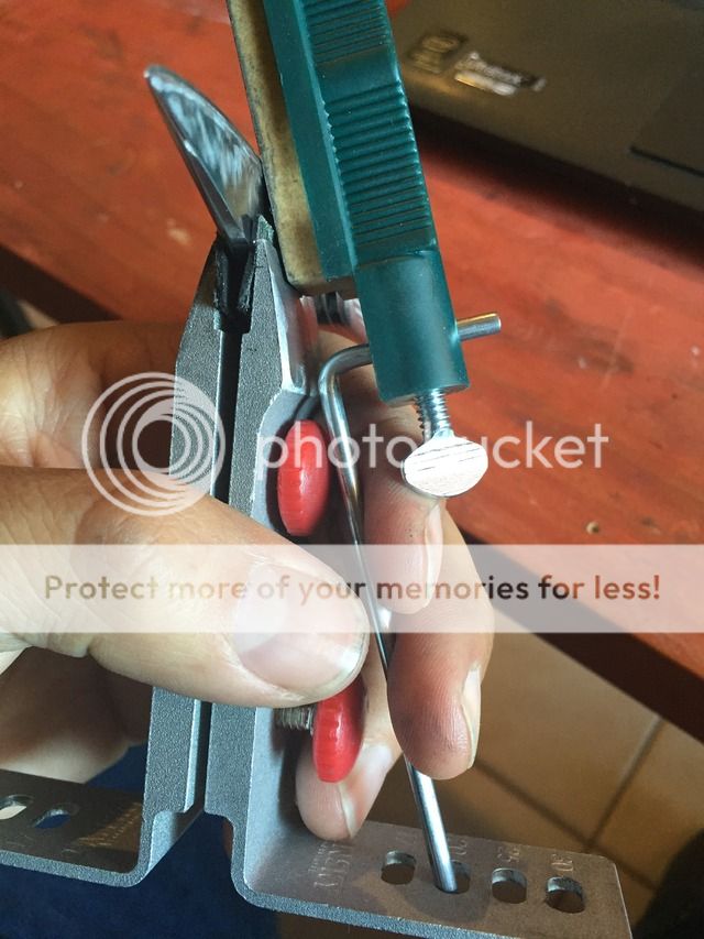

The Bracket has multiple issues because its the NEW design and the issues are more relevant with the small Swiss Army knives I have.
  • The rubber is squishy per say and doesn't let the knife tighten down.
  • The outer head of clamp is fat and hits the stone before my small knives blade does
  • The rubbers are too fat and add to the stone hitting clamp issue
Fix for me:
  • Grinded the tip of the clamp a lot
  • removed the rubber that protects the knife finish (will use tape later on)
  • With rubber on clamp tip removed the clamp KNOB can actually squeeze the knife tight

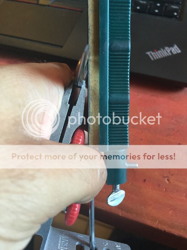

Stone hitting the KNOB at the 17 degree point
Here it hits the bracket (It used to hit bracket a lot more but I grinded the tip of bracket)
NOW it actually sharpened small knives and razor sharp to boot.. I was so happy that I can actually get the knifes to stay put in the bracket and have the stones not hit the knob or bracket...

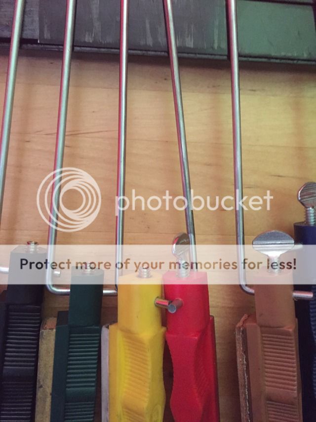

Been working with this to improve it further and while not original here is my future updates to the clamp and rods.
Rods: get 10-24 3/8inch set screws.
Now the clamp gets the same 10-24 L hex wrench screws but 1/2in long ( I do have 3/4in too)

Another thing I noticed by swapping to hex screw 10-24 was that I can actually squeeze the knife pretty darn hard in place which would be beneficial if you wanted to do a regrind and needed to apply more pressure. With the factory clamp screw or knob system any pressure and the blade would dance around both big and small blades.
