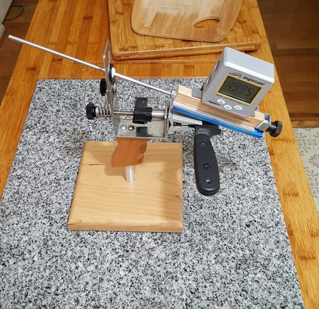

I agree with the KME, I had a DMT and really didn't like a lot of things about it including the fixed angles so I scrapped it and went with a KME with infinite angle adjustment between 17 and 30 degrees, (actually you can get a lot lower by turning the rod guide upside down). I've made a couple of changes to mine in order to use my DMT Aligner hones, I really like those and added a piece of steel to the top of the stone holder (got the idea from this forum to hold my angle cube, a really good sharpening system and the minor changes I made make it a great one. I looked at the lansky but decided that it just wouldn't work for me. For me KME resolved all of the problems that I saw in the DMT and Lansky systems and resolved them.
Here is my end result after changes:
