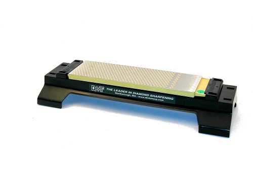

Have a look at the 8" DMT dual side bench stones. They come with a base, ready to go:

You won't regret it, especially when you intend to reprofile your knives.
