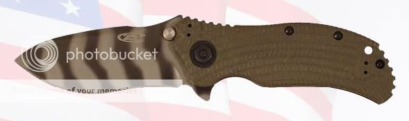

Also, would this sharpener work on a recurved blade like this?
Buying this at the end of next month.

Will the Lansky work on a recurved blade just as well?
Depends on the level of recurve in the blade.
In other words: if you have a very tight recurve, you'd be better off with something like the DMT convex hone.
But for something "lightly" recurved, like, let's say a Benchmade 710, the Lansky should work well enough.
I posted a picture of the recurve knife above.
Yes, I see now, sorry.
Anyway, it's sort of tough to tell without having the blade right up against the stone. But that ZT knife doesn't look so recurved that a Lansky wouldn't work.
If you find, however, that the geometry of the Lansky stone and the recurve of that ZT aren't a good match, you can pick up the DMT convex stone which I mentioned. It's great for recurves.
Might need the DMT guide rod for it to work with your Lansky clamp, though.
http://knifecenter.com/kc_new/store_detail.html?s=DMTASCG
better link here: http://www.dmtsharp.com/products/other.htm
I've used my Lansky on this Lightfoot and it worked well:
It looks to be about the same recurve as yours.
