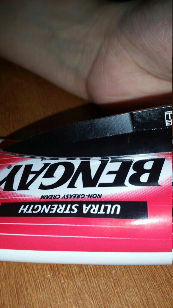

Yeah i did my first polish here. I'm pleased with it, using the paper method using #1 (heavy duty black), #2 (regular normal black), #4(light white ), and #5(green high gloss). Im pleased with the polished look, its mirrored. But it seems loke i dulled it somehow down the line of sharpening it. Its sharp just not as sharp as i want it to be. Maybe i just need more practice. And to hone my my technique down better? Hopefully ill get it soon i also scratched my blade up a bit today sharpening it :(. I used black electrician tape. I dont think i cared for it, thought painters tape worked better. But hell its a seven dollar knife lol. If i can ever figure out how to get it sharp enough to shave my face i can probably sell it dor thirty bucks still. Im using a 17 degree angle it doesnt seem sharp enough and wont stay sharp. Should i be using say 20, or 25? Then stropping it at the same angle? I want it to at least pop hair and i havent found out how to do thos yet. Say if im changing angles do i need to profile by starting from course to ultra fine, to saphire, to strop, to compounds everytime? Any help would super awesome.
Polished_tac_force_zps95e974ad.jpg.html
A LOT of variables there. I'm assuming you used the tape to try to keep the blade from slipping in the clamp? If it was slipping, that'd obviously create a problem in maintaining the angle, and therefore leaving a dull or incompletely-apexed edge.
And being a 'cheap' knife, there's never any guarantee the steel will take or hold a fine edge. Your mention that 'it won't stay sharp' likely hints at that a bit. Could also be a flimsy burr that's rolling over quickly in use.
In trying to get it to shave, you'll have to make absolutely sure to:
  • Guarantee the blade doesn't move in the clamp.
  • Sharpen at the lowest angle possible, in the clamp. Even if the steel won't hold the edge, shaving sharpness will verify the steel is capable of at least taking a fine edge, AND also verify the setup and technique is good. The vast majority of even 'cheap' steels will at least get this far, though many won't hold the edge for long. I have a cheap kitchen knife that will take a wicked shaving edge, but then rolls over if I look at it the wrong way, pretty much. ;)
  • For stropping, I'd start as simple as possible, without trying multiple compounds. Take the edge as far as you can in polish on the hones (through your finest hone), and then use something like the green to strop it afterwards. Most 'cheap' stainless steels will at least respond to green compound, but more aggressive black and white compounds can often be too aggressive for them, resulting in an over-polished and dull apex.
Don't know if I've hit all the bases, but that should give you something to run with for now. :)
David
