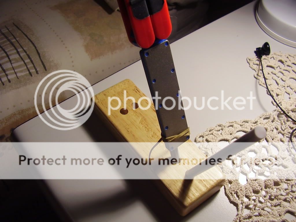

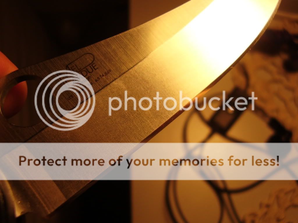

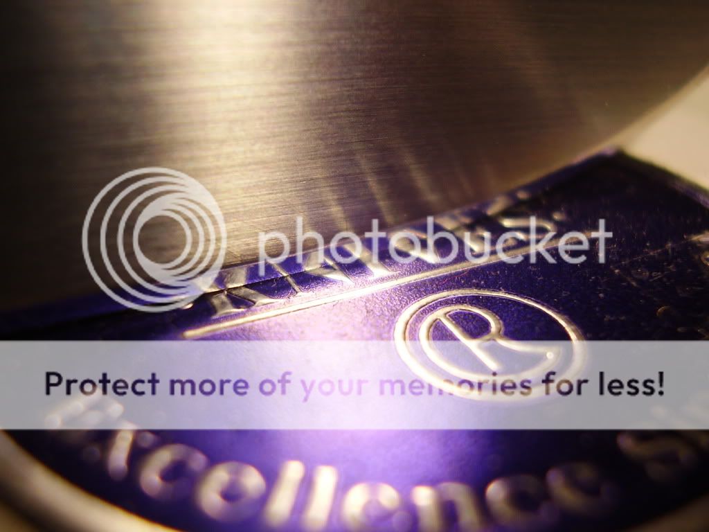

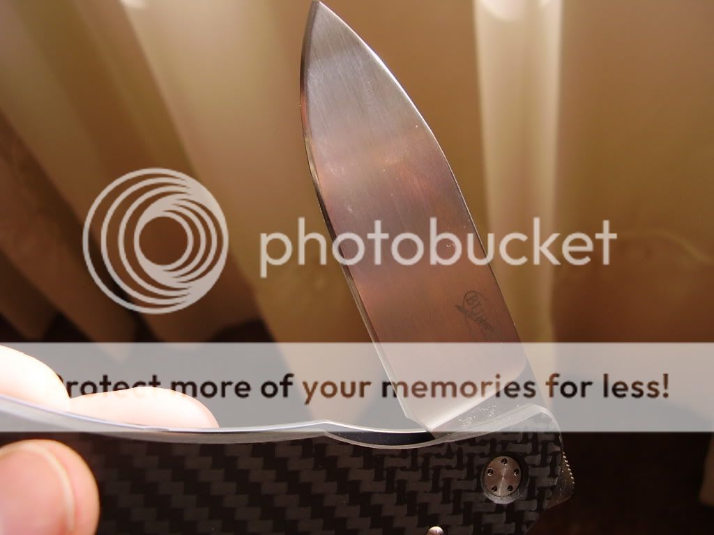

I love mine, use it to maintain my micro bevel at 20* on a reprofiled 17* inclusive angle, I bought the fine stones, works great and I did a lot of traveling so it was easy to put away and take out when I needed it. I also strop afterwords and these are the edges I get.
Sebenza Insingo 20* inclusive, no micro bevel:
Burger EXK1 with N690 Bohler, 20* microbevel with 17* inclusive edge bevel:
Benchmade 550HG 154CM
