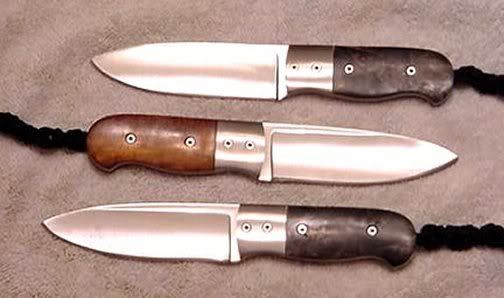

Unky, there's another way you can do the lanyards and not have to use metal tubes or even drill holes in the handle material! :D
I think it looks better than having a hole through the handle and
it's easy to do.
Here's a pic of some of my neck knives I did that way. I thought I had a pic showing the butt end with the lanyard and all but I must have lost it.
This is how I used to do the lanyards on some of my knives back in the day. You just drill a 1/4" hole in the tang about 1/4" from the edge and to make room for lanyard under the scales, you use a 1/4" straight cutting router bit to cut a slot about 1/2" long. If you don't have a router or any router bits, you can use a milling machine or drill press and end mills.
Hope this comes in handy!!!

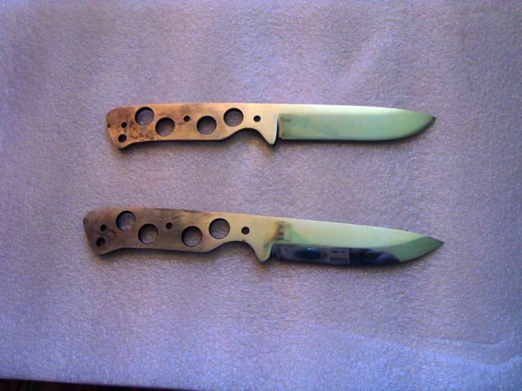

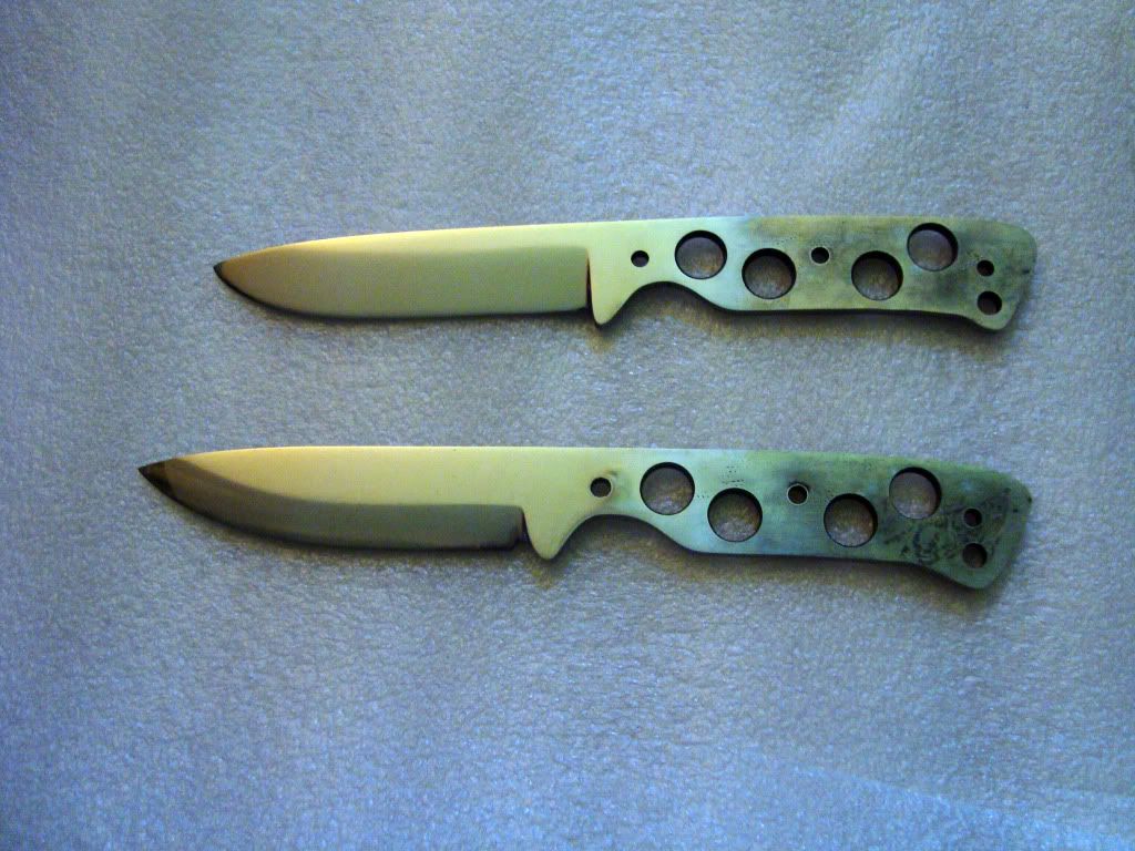

Both knives I am working on will have maple burl scales, one is natural unstabilized scales that I will either do the crazy glue finish on or tung oil and the other will have blue dyed and stabilized scales.
Both have nearly identical profiles but one is convex and the other is a scandi grind. I am doing them for an extremely belated 1000th post give away:o. the winner will get the choice of the two and the other will stay with me. They are my best so far, just wish I had the means to put a makers mark on them.

Unky!...... the patina on that bottom blade looks just like the Blessed Virgin Mary using a camera! ..... it's a miracle, dude. Call the National Inquirer!!!!!
The knife is PRICELESS
