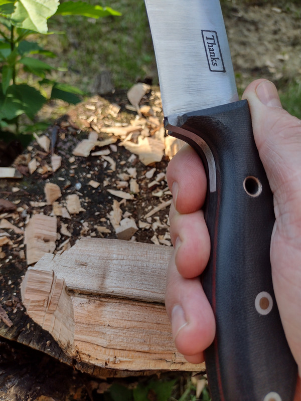

I'm planning on using paracord (diamond-in-monkey's-fist knot) or leather thong (sort of like Horsewright Horsewright 's knives) for a lanyard on a few knives for friends.
Where is a good place to get tubes: stainless, brass, copper or even something like carbon fiber?
Since I'm gluing it in, I don't imagine wall thickness is a big issue - but inner diameter, like 0.25 inch?
I have seen some other knives here with somewhat larger holes that 0.25 inch ...
The knives are going to be something similar to a Sloyd knife, but I just like lanyard holes in general.

I get 5/16" OD, 1/4" ID stainless tubes from amazon. I also get the same size (5/16" OD and 1/4" ID) black micarta tubes from Current Composite. I have some brake line tubing here, but haven't used it yet. I hate lanyard tubes that are too small to fit paracord through! I've also found some thicker walled stuff at Pops and other knife making supply places.
I agree about hating the smaller diameters alot of people do..... That is one of the reasons I when with the brake line. It's 5/16" O.D. and aprox. .035" wall thickness.
I wanted them to flare easy, too. I dont like seeing them Just glued in. Without and mechanical fastening means. that's just a weak joint.

I agree 5/15" OD is the size I like. I tend to use brass tubing - these B0CLV3KJ84 from Amazon. They're about .020" wall thickness and flare nicely after annealing before flaring.

I don't have a fast way of doing it. There is probably a faster way.
In my opinion, the most difficult part is getting the length and the centering of the tube in place.
What I found that looks best is....
1. Align your handle scale material with your hole in the blade's tang.
2. Glue/epox up your handle. (I also generally use fasteners too. I like very secure handles)
3. clamp/Let cure
4. Shape handle to size, maybe do most of the handle sanding.
5. CT'SK chamfers to size. -What looks good to you? I don't like them too big.
6. Cut tubing a little proud of the thickness of the handle.
7. Glue/epox tubing in handle centering it. *Make sure no glue is in your chamfer area, only in the bore.
8. Let cure
9. grind flush with handle, sand tubing edge to look nice. (IMPORTANT/Be careful not to mar or gouge your nicely finished handle)
10. Press/Flare tubing into your chamfers. I use a small arbor press.
If everything worked out it looks good.
-kinda a pain in the butt, but it works. glueing the tubing first, ensures it doesn't slip, and shift, making it look off centered.
