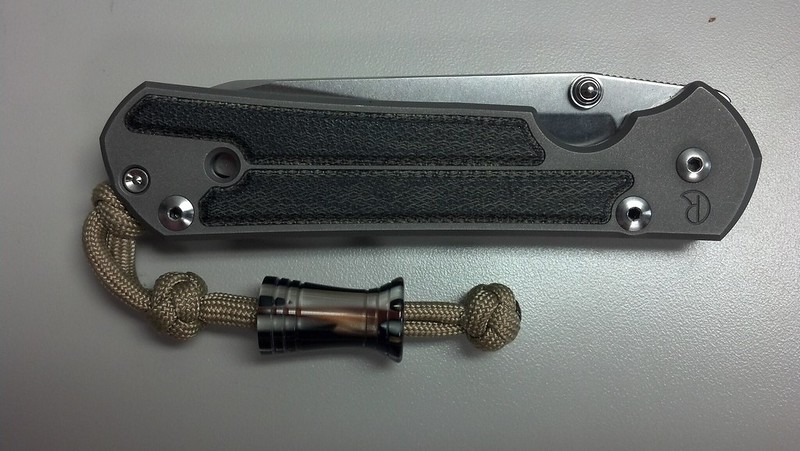

I think CRK uses a 250 or 350lb spec. cord - NOT 550 paracord. I do not like their lanyards at all, and always remove them and immediately tie my own. I tried going without and it felt awkward. Here's what's in my pocket now (Large Insingo):
Untitled by mysdnc, on Flickr
Onespdfrk, that is a great lanyard. How do you tie that style?
Thanks! Go to YouTube and search for "paracord ball knot". There's several good instructional videos there.
I made the bead out of an acrylic resin material. I like this because it doesn't scratch the titanium like metal beads.
Also, if you use 550 cord on a CRK, you need to remove 4 of the 7 inner strands to allow it to (rather snugly) pass through the lanyard pin hole.

Good info, thanks for that. Nice tying you're doing. :thumbup:

You just need to remove an inch or so of the core strands and melt the outer part into a point after you pull it back over, you can pull the rest of the cord through easily if you do that and it keeps the cord firm. It is too baggy and doesn't tie well if you remove any of the inner strands, IMO. It is worth making sure the lanyard pin has no burr or sharp edges too. :)

Very good information. Thanks for that also. :thumbup: I hate baggy lanyards almost as much as the smell of burning paracord. :D
