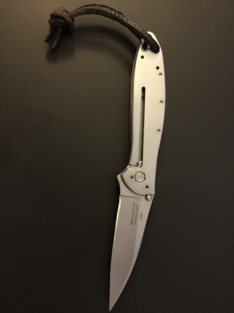

Here's mine with a simple leather lanyard.

Thanks for the pic.
Looking to do something like this but in blue and gray.

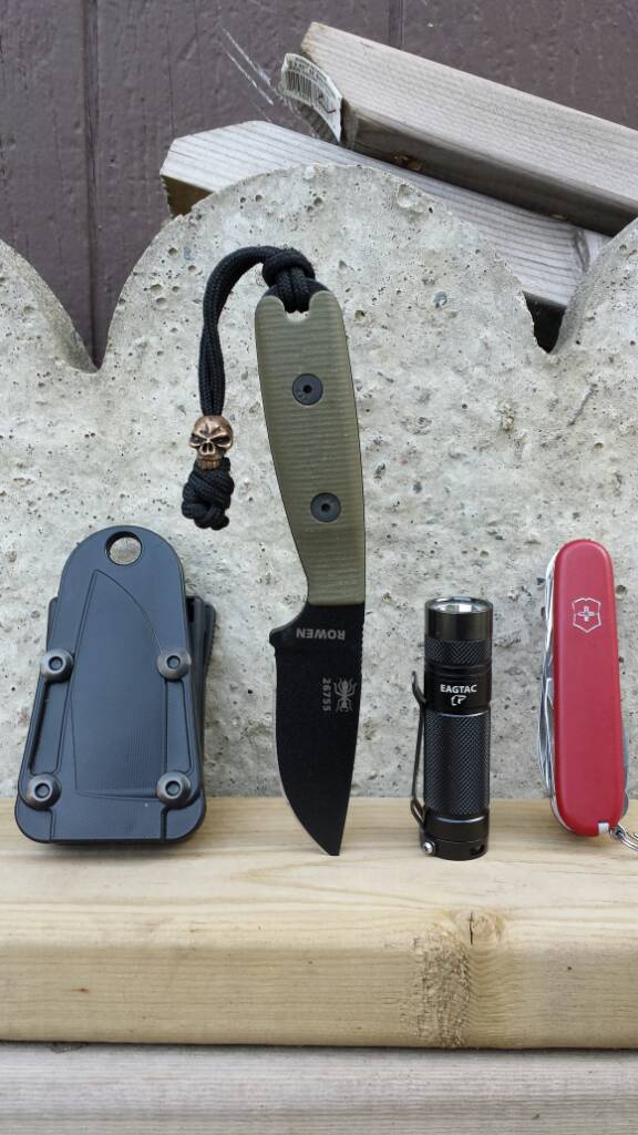

Those are gutted. If you use a loop of dental floss (or the 550 innards) to pull the lanyard loop through the hole you'll have no problem. The gutted cord actually compresses quite well. The bead is a nice way of finishing of the ends.

That is 4mm 550 paracord in that pic by the looks of it. Pretty simple design with a simple cobra braid. 4mm 7 strand 550 pound is the most common cordage for lanyards but, if it doesn't fit, you can get a bunch of other smaller sizes like 3mm 3 strand 425 pound exc.
I find large lanyards like that to be uncomfortable myself. Their too heavy and swing around too much. I make mine with a standard noose knot and a bead. That way it can tuck through two fingers if needed too for retention.
