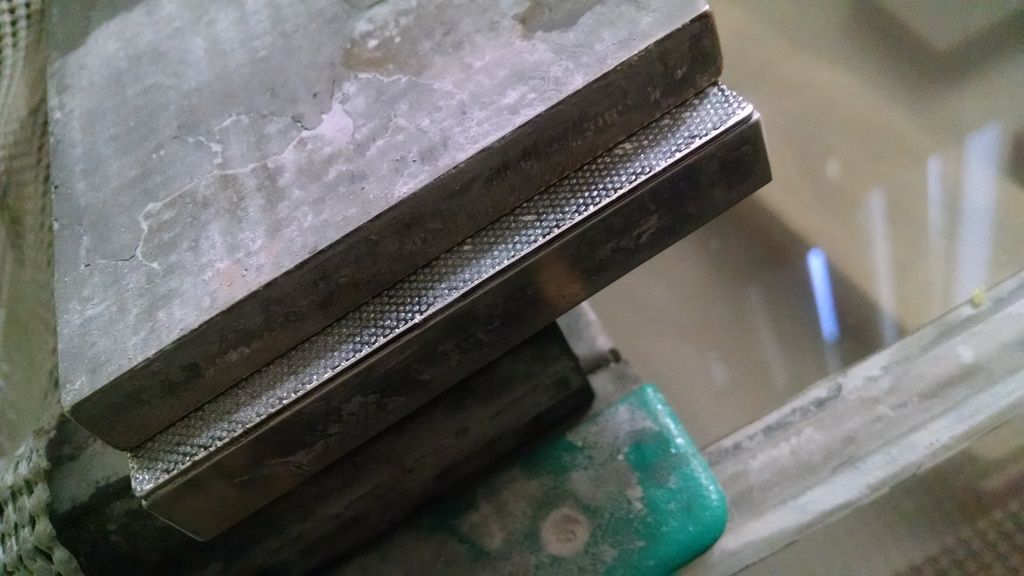

Hello, I'm new here. I hope I'm posting this in thee appropriate section. Decided to get my feet wet with knife sharpening recently. I purchased 220/1000 Norton combo stone. I have a bunch of kitchen knives with wavy edges so I figured the 220 grit would be good to straighten out the edge?
The thing I'm not sure how to do is lap this stone. I own a DMT 325, is that appropriate to lap a 220 wetstone? I always assumed you needed a lower grit lapping plate. I can't seem to find wet/dry sandpaper in a grit under 400.

why do you need to lap the 220 side?
A simple search for "lapping DMT325" shows straightrazorplace guys talking about doing this...
so it could work to flatten the waterstone ... use at your own risk :D
A slightly lower grit is important for conditioning stones after they're flat
But since (the internet also says) the norton waterstones are soft/weak bond
they shouldn't need conditioning , just make them flat, use them
Speaking of sandpaper, got an old beltsander belt? Wrap it around a flat piece of lumber use it as a flattening stone (or cut+nail to wood)

Sanding belt around a piece of wood is a handy tool. Smaller hardware shops sometimes have a better selection of silicon carbide wet/dry (the black/dark grey material) than the big box stores, a couple sheets of 60 or 80 grit will come in handy, use over a hard surface like a brick and plenty of water.
I've also used the $6 cut off wheels for metal chop saws, again with plenty of water. The 220 is coarse enough you could get away with using a flat stretch of sidewalk and plenty of water, use a figure 8 pattern and swap ends often.

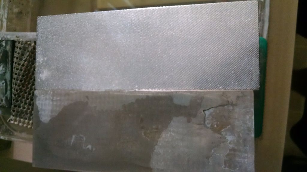

I would not use the DMT unless its an Extra, Extra Coarse.
It will be a big help to work the entire surface of the 220, its a notoriously soft stone and will rapidly groove and dish if you only work one area.
Lastly, some wavy edges are caused by warps in the blade - give them a good looking over before deciding how to proceed.

The point of my rant is I would flatten a Norton with diamonds.

ONLY, the XXC DMT or Hardcoat plates are rated for lapping duties, all others plates are used at your own risk.
Other options are the Noton or Naniwa leveling stones, I believe the Naniwa is around $20 and the Norton around $50.

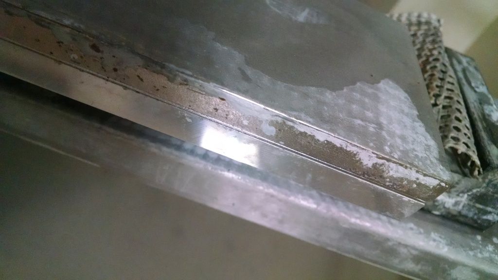

I used a Smiths 325 grit hone to flatten out dished spots and maybe it was just the extra small surface area concentrating all the abrasion in one spot, but the 220 eventually ground the diamonds out of the nickle substrate.
Norton make their own flattening stone that costs less than a DMT plate anyway.
They are not always flat though so it's a buy at your own risk kinda thing.
Yea forgot about that , I bought the 400/1000 combo plate for CKTG and I don't have calipers but I used the 400 to lap with no issues and even checked by lapping with the dnt xc after the combo plate and it made no difference .
The combo plate is good, it's the generic 140 that can have issues.
