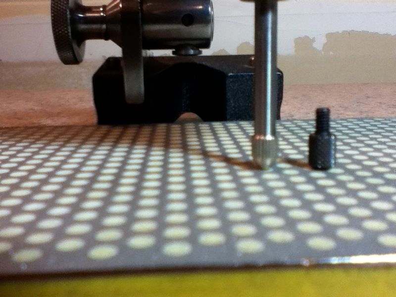

The pink stone with the deep "zig zag" looking line in it was "designed" to flatten stones. When I got it it was not flat by a significant amount as compared to the Diamond plate and checked on the Starrett surface plate. I don't have the specs in mind or any place I can look them up but the stone rocked corner to corner and was some what hollow. The diamond plate did not rock at all, at all, was not hollow to a spec on the order of a thou inch across the whole length.
I used the diamond plate to FLATTEN the pink/zig zag stone flattening stone and to maintain it.
These photos are many years old. At the time our main interest / point of discussion was the depth of the holes in the plate. Some said that the fiber reinforced yellow plastic was flush with the diamond and prevented adequate abrasive action and my point was that MY PLATE at any rate was not that way and that the plastic was indeed well bellow the level of the diamonds. I measured it and posted the results. While I was at it I studied the over all flatness. Some said the plates were woefully out of flat. I measured MY PLATE at any rate and found it to be VERY FLAT and way beyond what I needed to keep my stones flat and flatten the backs of woodworking plane blades (though the 220 grit diamond proved very slow at flattening those blades and I moved on to much coarser (60 to 80 grit) zerconia alumina "sand paper" (cloth belts actually) glued to a flat surface).

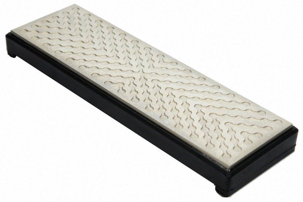

When I hear "lapping plate" I think of the glass the OP mentioned with grit sprinkled over it and the following with the deep grooves (very pricey and pointless).
Now I understand, I think, that the "lapping plate" was what I would call a diamond sharpening stone and looks like this and costs much less. Is that true ? Then by all means.
All I was saying was avoid the lapping plates using grit and the glass using grit and just use a coarse diamond plate of known flatness.
