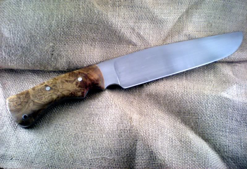

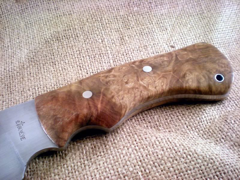

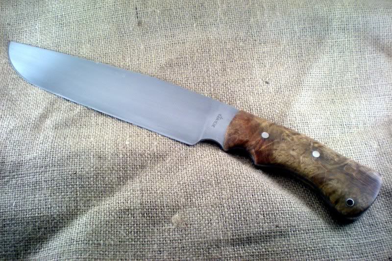

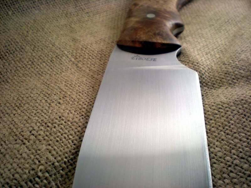

Here's one I finished up today. The handle is burl, however if someone can identify it, I'd be appreciate it! I was thinking it's Afzelia, but for the life of me I can't remember what it is. Have a pretty good amount of it too! Let me know your thoughts!
Blade: Flat ground 3/16 O-1, hand sanded to 400 grit
Heat treated by Peters Heat Treat to RC 59-60
Handle: Mystery Burl
Pins: Stainless Steel Corby Bolts
OAL: 15 1/2
Blade Length: 9
