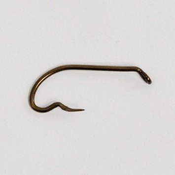

This style of hook, which I found out about salmon fishing in the Pac NW, I think are a better style! Can't remember a big salmon ever tossing one despite the lack of a barb. Might be worth making one since you're forging your own hooks!
Hey Mecha,I,ll have to look into that style of hook,maybe a west coast thing.
Thats the hook pictured with the hand although that one looks thicker.
