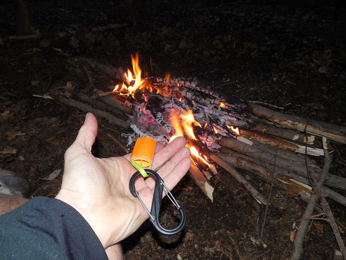

I made this fire soaking wet after a dunk in a ice cold stream using just the DIY firestater which took a dunk with me. Zero tools and foraged the wood cold and wet after my swim.
It was just to practice skills.
No tools beyond my cold hands, feet and empty Bic DIY thing.
It's very doable to make a great fire with nothing or like you correctly stated with minimal tools. That said everything IMHO is situational. Oh and nice taste in knives, the Farmer and Mora! :)
