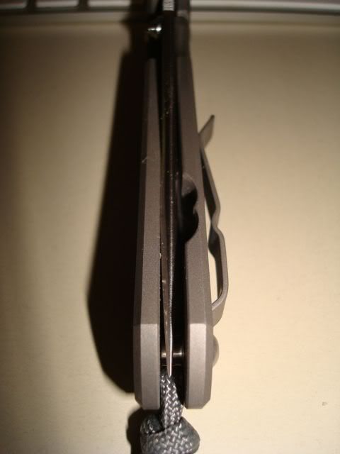

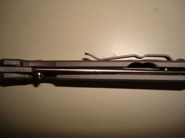

The blade of my large Sebenza is definitely not centered. Could I have done this when replacing the lanyard, and not centered it on reassembly? Kind of new to CRK, my fourth should be here on Friday :) Any help would be appreciated.
Can I see a pic? I have never heard of such a thing unless it was not put together properly. Take it apart and be sure the washers are in the proper place when you reassemble.
Define off center? It's not uncommon for frame-locks to angle towards the non lock side due to the lockbar pressure.
Here are a couple pics...
You might have pinched a washer between the handle and pivot bushing. It's happened to me a few time after cleaning mine, all you need to do is take it apart and make sure the washers are in place before you tighten the pivot.

That must have been it. One of the metal washers (?) that sit on each side of the hole in the blade wasn't seated correctly. Much better now. Thanks for all the help everyone!

100% have a washer "crimped". I promise. I did EXACTLY the same thing to my umnumzaan!

Super old post, I know, but your comment just saved me some major grief. My Sebenza has always been perfectly centered after disassembly, but this last time it wasn’t, and lo and behold, the larger washer turned out to be off center by a smidge. Thank you!
