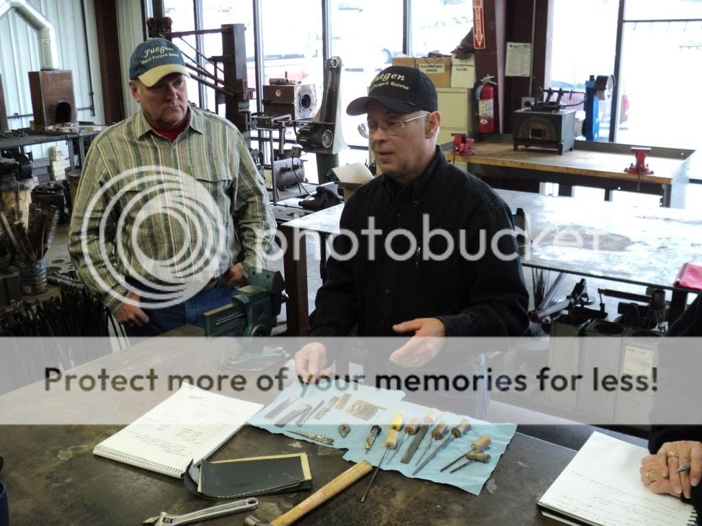

I foud out that Larry Fuegen was doing a one day seminar at the New England School of Metalwork. Attending was obviously a no-brainer. I have always been a big fan of Larry's work. The seminar was among the best I have ever attended.
On with the pic's all right all ready!

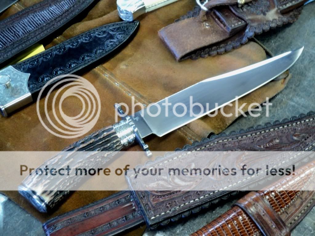

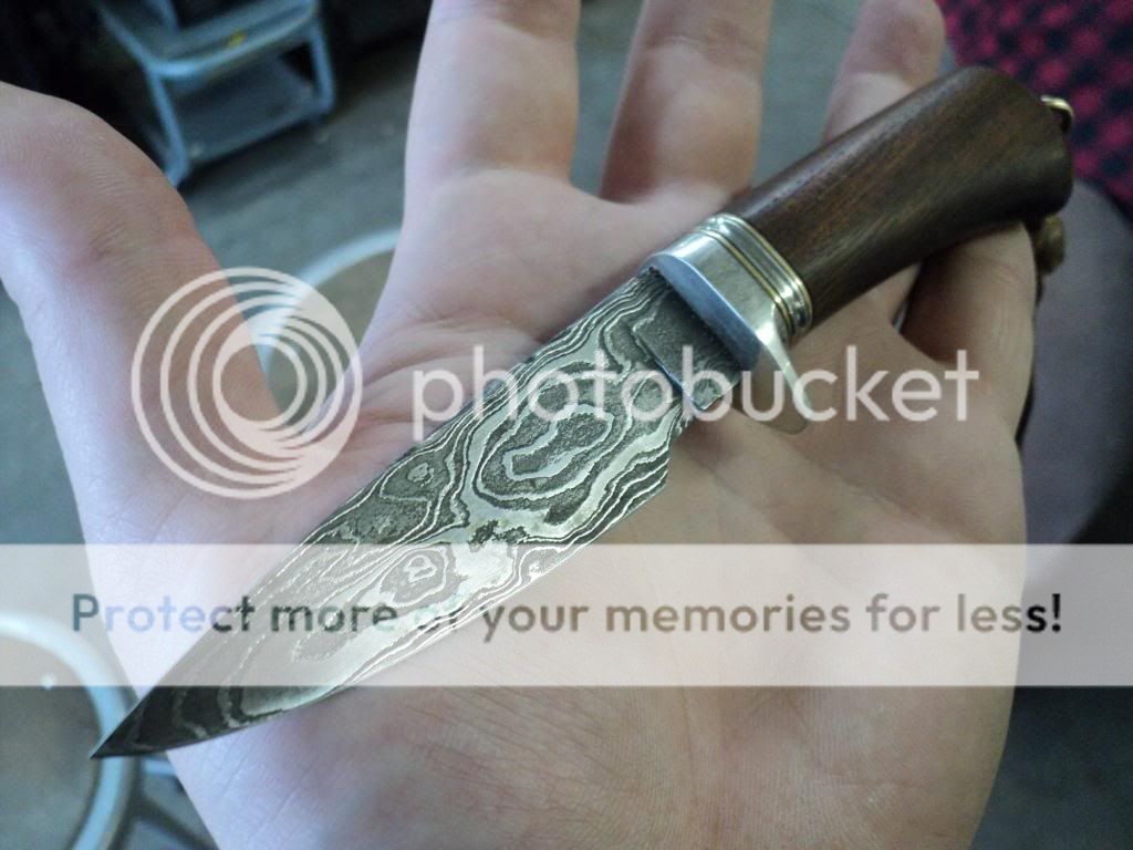

Marcel Morin, local knifemaker was there with a classic Fuegen piece from when Larry was living in Wiscasset.

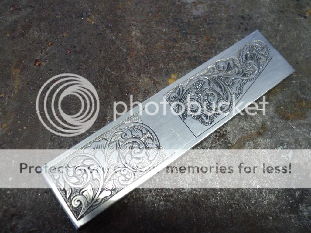

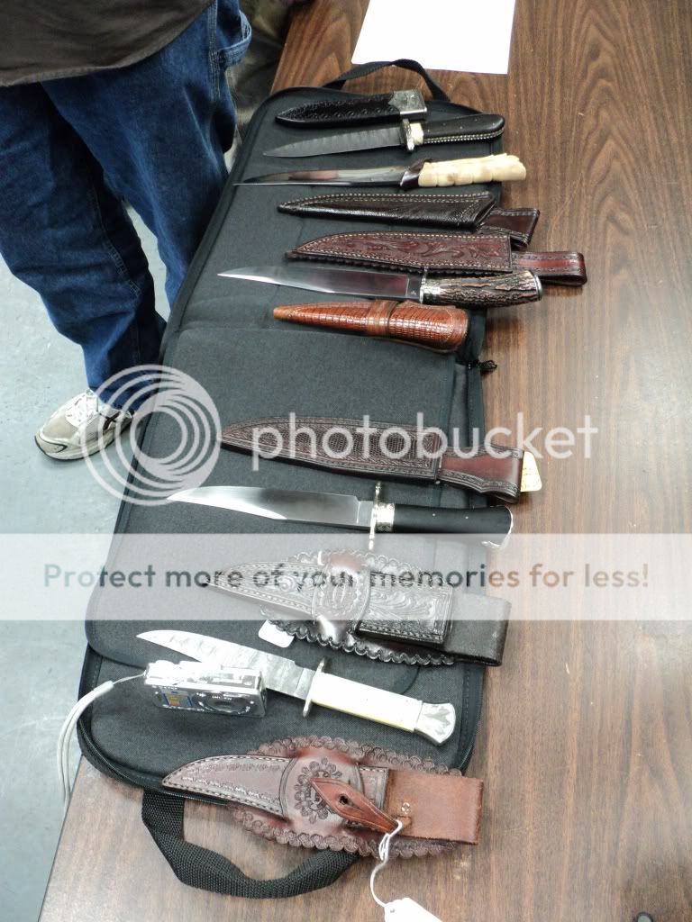

Ged Messenger brought a very nice collection of Fuegens for us to apply fingerprints to. Ged actually bought the very first knife I ever sold.

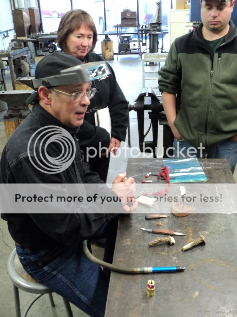

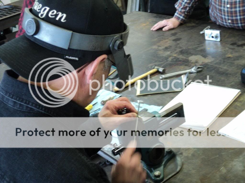

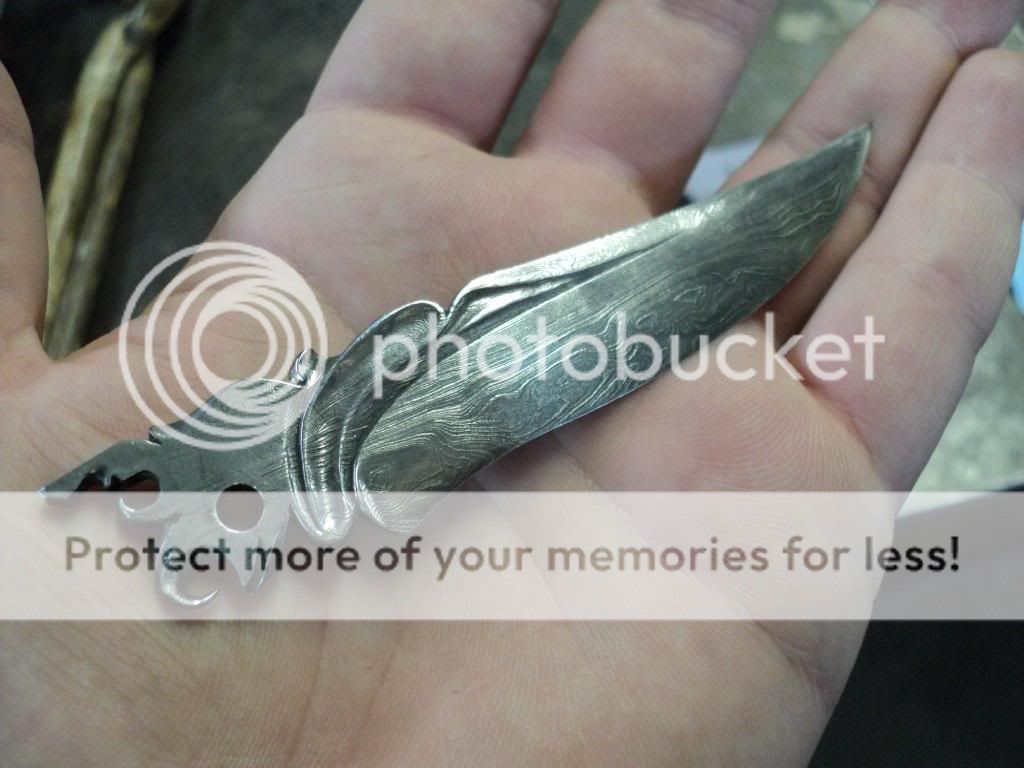

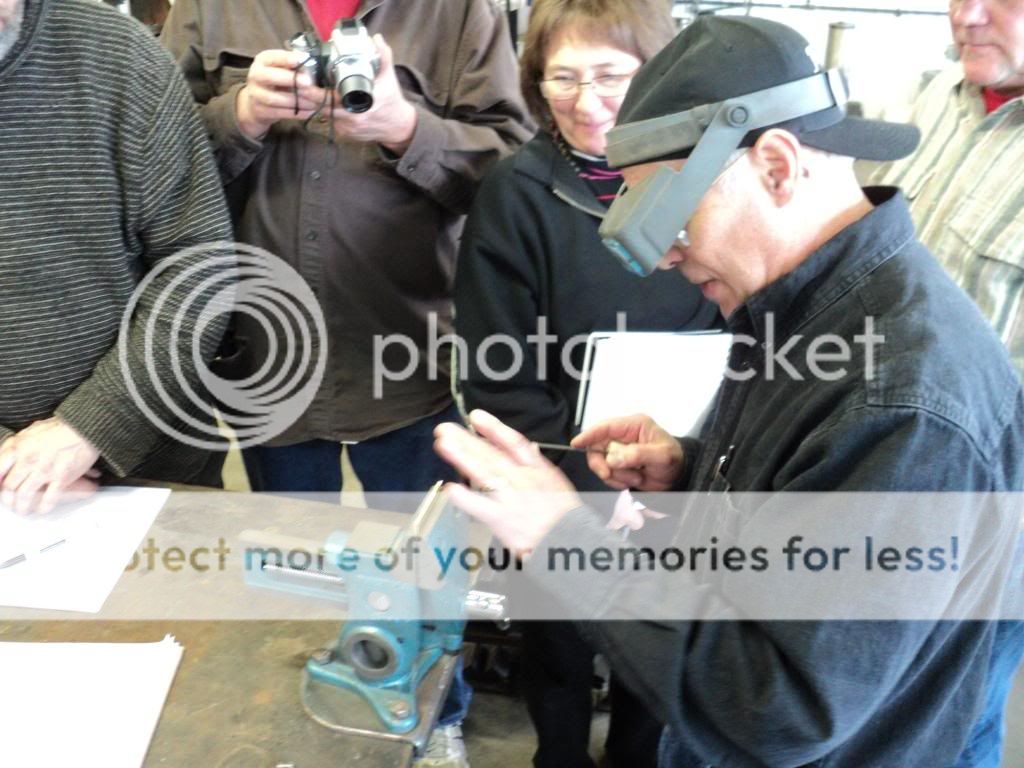

Filework demo.

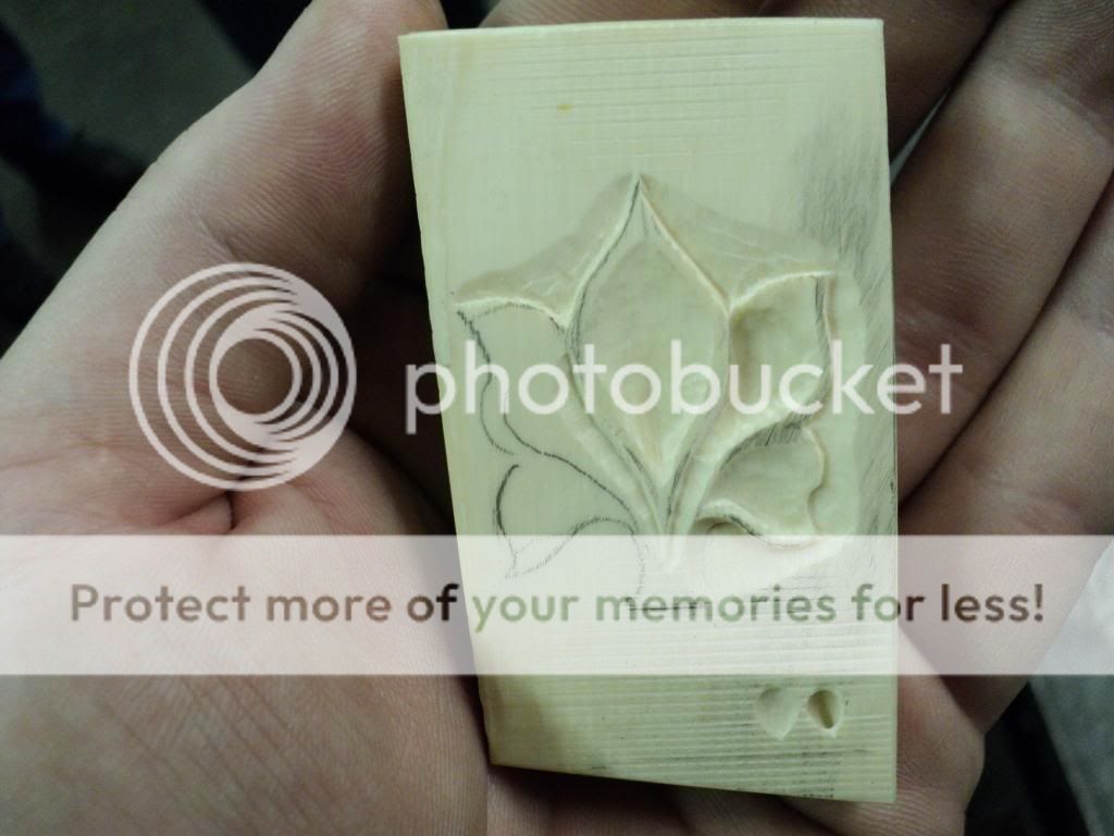

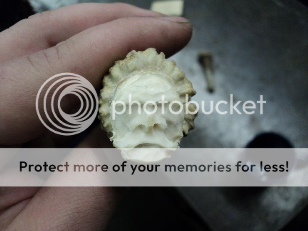

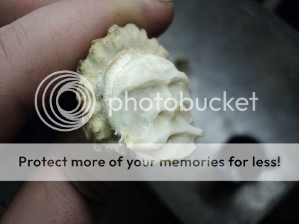

Carving progression.
An enviable afternoon; making the complex approachable.

His teaching style is fantastic. By the end of the day I thought my brain was going to explode.

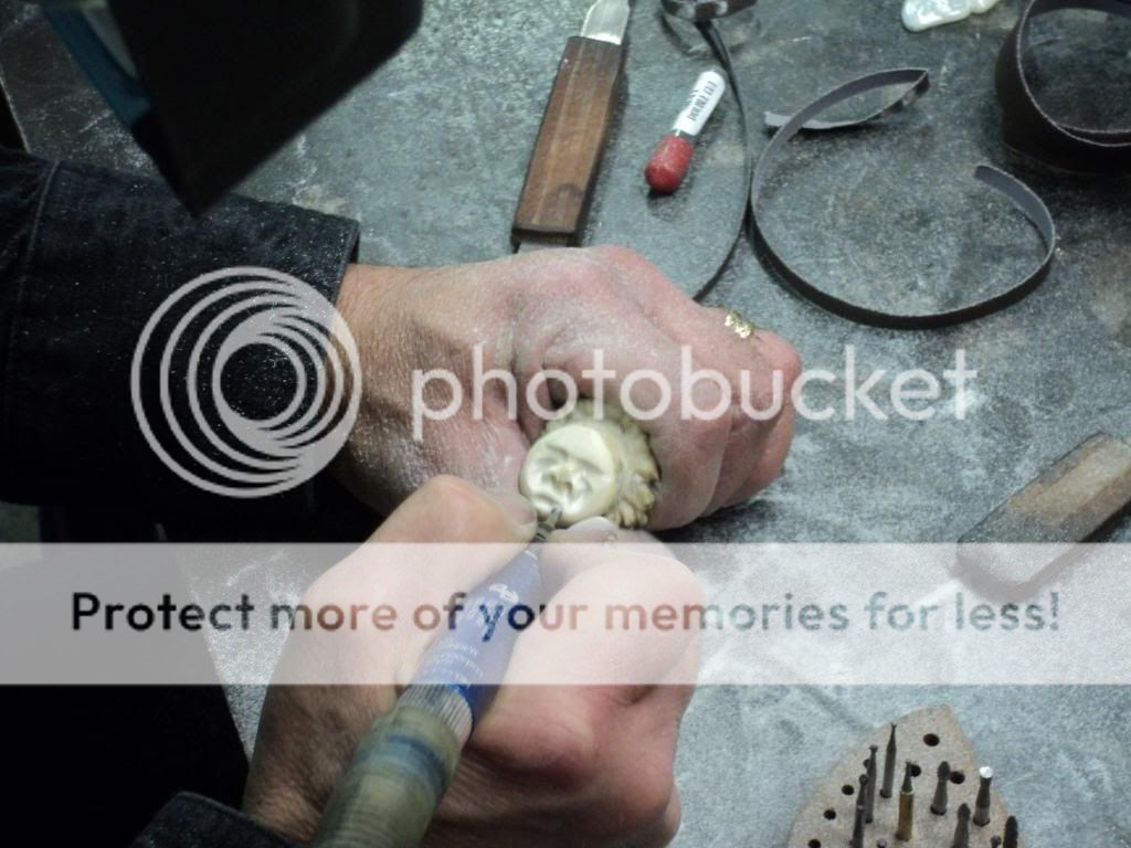

The filework demo was extremely valuable. Larry demonstrated all of the Jim Schmidt patterns and his own "secret" pattern. I had been only working from one side of the spine. Larry was flipping the blade in the vise to get maximum contour. Also he uses a pneumatic pencil grinder for carving. Fordhams do not have a high enough RPM to carve material that has hard and soft layers like wood.
Overall, I learned that simple tools used with extreme skill is the direction that I want to take my knives.
-Nick

I just love that big stag and carbon Fuegen bowie.

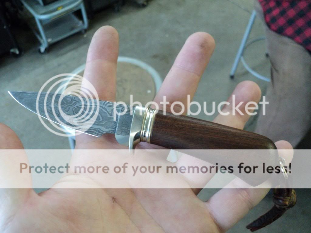

Me want one of those little Personal knives. Nick, that's a not so subtle hint, BTW. ;) :)

I agree Bruce, never seen that many Fuegens on one table at a given time. Nick, were they for sale or just for viewing pleasure.
Great looking sheaths there too. :eek:
Thanks Nick for this thread.
Thanks Mr. Jones,
The knives were just for viewing, and the sheathwork is certainly as good as the knives.

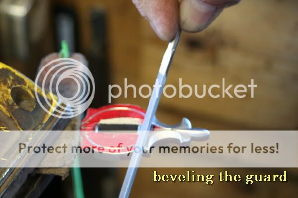

As a beginner filing guards for that perfect fit, I've thought of a mill and a surface grinder but have decided to master the file and layout skills first.
I noticed simple tools on the bench in your picture.
Mark Behnke

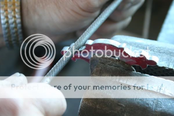

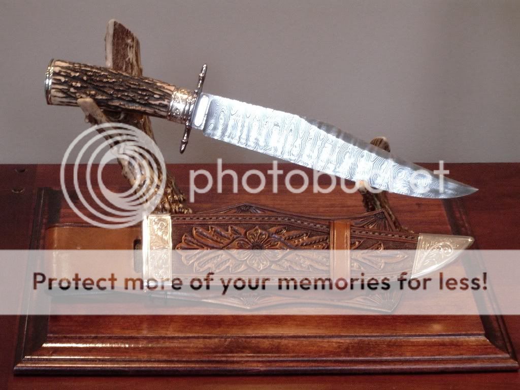

To your point, here's Larry filing a guard for a recent bowie he made for me.

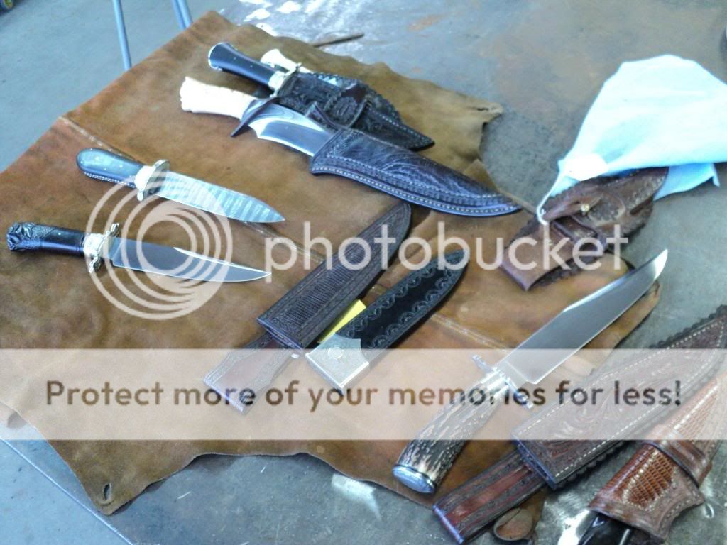

Thanks for those pictures Kevin. Assuming this is the guard for the "Buckaroo Bowie" could you elaborate on the Hancock safety notch .
I don't see how the guard connects to the throat if that's the case.
Hope this isn't a hijack?
Thanks Mark
Thanks Mark
Mark, the two little decorative tabs on the guard fit perfectly into the slot cut into the loop of the sheath and secure the bowie. Then you just tilt the bowie handle slightly away from the sheath loop and the bowie can be drawn from the sheath with ease.
Sorry for the poor photo, however it shows the slot very well.
