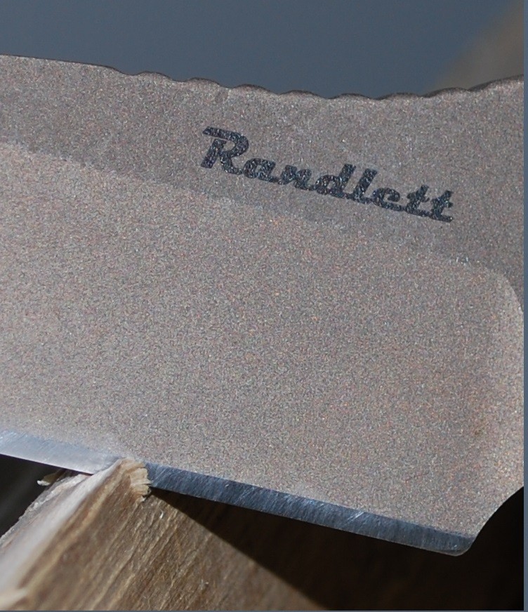

I have a customer who wants his brother's name put on the blade. If I were to take the knife to a trophy shop and have them engrave the name do you see any problems arising? Or is there a fellow knife maker that you know of that can make a single stencil?

You can get a custom single name stencil for a great price at Blue Lightning Stencils by Ernie Grospitch. I used this service once for a customer and was impressed. He makes all of my stencils. link ---> http://www.erniesknives.com/Customer's Personal Stencil Addition.html
Here's a pic, the stencil was to commemorate a yearly hike made by a group of friends. Ti Bottle Opener Knives made a ways back...

I talked to ernie. It was $8 for the custom stencil. Not a bad deal. Does anyone know how much the laser engraving cost?
I posted this too in the etch-o-matic thread. I am closing in on results that I would call professional... Below is the speedball emulsion on fine mesh. I have since discovered an emulsion sheet that works much better and is far more crisp. It can also be applied directly to the steel and then exposed. The benefit of the screenprinting stuff is you can use a positive image. The PCB stuff and the photoreactive film usually takes a reverse image.
