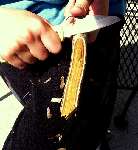

Ben wanted to carve a set of flat ware for Mom (spoon, knife, and fork). He got a whittling book for Christmas and has been wanting to try various projects from it for a while. Generally, I do the big stuff and he finishes the detail work that requires less strength (most of the wood around here is pretty hard).
He went out back and selected a few sticks from a pile of Poplars I cut a while back and started forming a knife. Basically these are good for spreading butter, or jelly...but we call them knives anyway.
I was rather taken by the beautiful grain of this wood. Unfortunately the pith was VERY soft and it made a rather poor knife, but we were determined to make due.

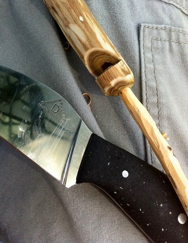

The really soft pith got me to thinking about a project I saw another forumite do a year or so ago that I always wanted to try...a whistle!
We started by cutting a short stick and boring out the pith a few inches deep (and packed some mud in the bottom of the hole to prevent the hole from growing out the back end of the whistle.

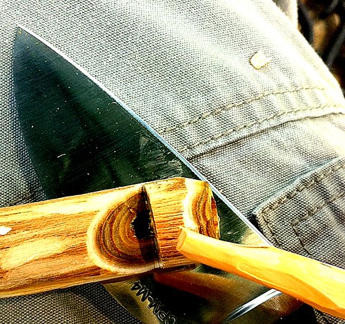

Next I rounded the mouth piece a bit and cut the wedge as shown. The cut needs to go about half way through the diameter bored from the center. Then I found another stick to whittle down to the size of the hole.

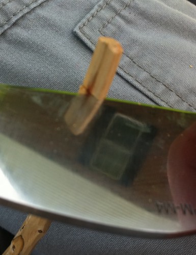

This is probably the toughest part...whittling this stick down to the right diameter to fit very snugly in the hold. Here it is to a nearly perfect fit.
Next we mill a flat side on the small stick. I aimed to remove about one third of the thickness.

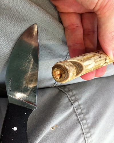

Next, we put the plug in the hole with the flat side facing the same side as the notch. Then we trim the plug to the length of the mouth piece (it extends from the tip to the notch).
Not a perfect fit, but fairly tight so that it does not fall out and air does not freely move around it (except where we want it too).
I realize that this was supposed to be a gift from my son (not me) but I was excited as this was my first whistle...so I did much of the work. I handed it to Ben to do the finish work and remove all the brown bark. He continued until it was nice, smooth, and uniform...then he would not let me get it back for a finished photo
