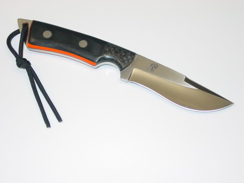

This is for my friend Jason. Recurve. 4.25" blade made of 3/16" CPM D2 with a nice satin finish. Swedge is sharpened. Overall length is 9.25". Carbon fiber bolsters with black micarta pins for subtleness. Scales are made from 1/8" black G-10 and 1/8" blaze orange G-10 with black liners. Exposed tang/ skull crusher. This is the second knife I've made from CPM D2. I love the stuff. It finishes great, but is tough to grind. It just eats up the belts, but is scary sharp. Enjoy!
-John
Thanks everyone for the comments. I'm sure the handles aren't for everyone, but that's why they call them "custom knives". I'll definitely be making more CPM D2 blades. Stuff gets crazy sharp!!!!!
-John
That knife is just calling me to it...I really love that design. And what are the odds, my name is Jason also. Now I'll have to get one of those...:D
i love that knife. looks scary sharp in pictures, im sure its even better in person. is that a .380 auto sig?
-Lou
That's just a crazy combo, in a good way. I especially love using MICARTA PINS in the CF. It just boggles my mind, that someone (you, probably :p) came up with doing that, and that it turned out THAT well.
