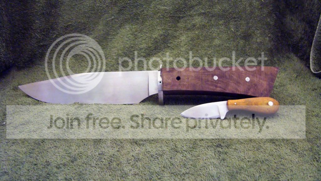

So a little while back I was looking for some handle material suggestions for a knife I was working on. Robert Mayo was kind enough to sell me a piece of would that fit the bill perfectly, and a few people had asked to be updated on the knife. Well I am going to be shipping it and one other out for HT tomorrow morning so I thought I would share them before the went away for the next step. Both of these were filed out on my jig and should be the lat two that get made with it now that I have my grinder. these will most likely be the last two before I move back to Ontario.

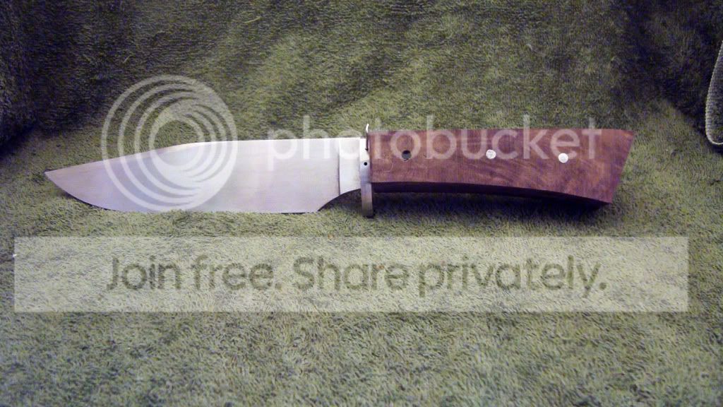

This one with Robert's walnut. It doesn't show well in the picture, but this wood is really active, a thing of beauty. I think it may have been a good thing that I missed out on that piece of ironwood that got me in a panic.
13/64" 5160 overall length when finished with pommel with be 12"
And just for a size comparison, with the little one I made on the weekend

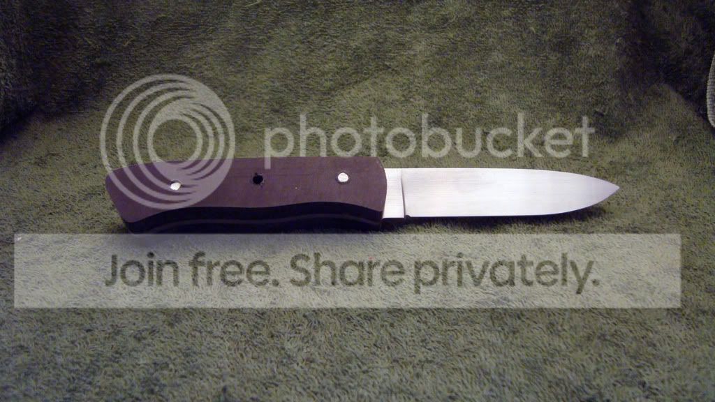

This one is going to a friend as an engagement present. Black Linen micarta scales on 3/16 O-1 with an overall length of 9 1/4"
I just have to wash them down, package, and ship them out. I should have them completed in 2-3 weeks if everything goes as planned.

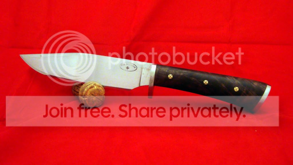

Rob at knifemaker.ca is the man:thumbup:, and Canada Post is motoring this week:eek: I sent these out on the 9th, they made it to Rob on the 14th and they are back in my hands this morning, got here about an hour ago. I am going to try to get the Bowie finished up this weekend and the bushy by the end of next weekend.

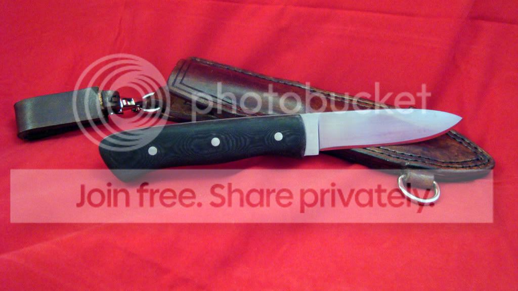

Getting real close on the first one, right now all I have left to do is a couple of touch ups, my mark, sharpening, and the sheath. It is the sheath that is holding me up right now, the guy that bought the knife is trying to decide what he wants. I save the touch ups, makers mark, and sharpening till after the sheath is made just in case I slip while making the sheath. I may still snap a couple of pictures and post them of the unfinished knife because I really like it. I like it enough that I am tempted to give back the deposit and keep it:p

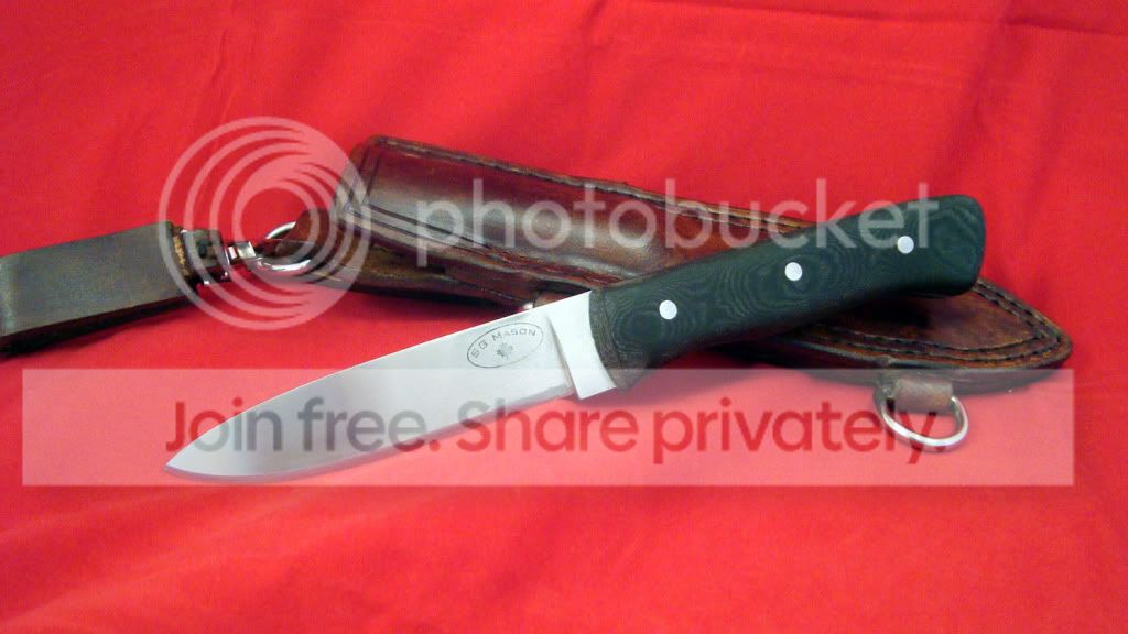

Well the first one will be done tonight, everything was looking good, handle looks great, the guard and pummel fit well with no big gaps, the blade took a nice satin finish, the sheath looks and fits great, but...
My makers mark looks like crap:grumpy: First off it is nice and clean on one end, but on the other it is blurry, the next problem is that it didn't darken up at all. Well not enough to stay during the clean up. The one that is a real kick in the nuts, is that the side that is nice and clean is too deep to sand out and do it over again so I am stuck with it the way it is.
Well I am off to go sharpen it now, I am up in the air about giving my customer a discount for the ugly mark. If I had charged what I think its worth I would discount it steeply, in the range of 50%, but I already sold it to him for less than 50% of what I think its worth. If I give him more off because of the makers mark I barely make what I have into it..
Finished pictures later tonight or early tomorrow morning
big bummer about the mark, reguardless though the knife looks amazing. it blows me away that you did that with no power tools.

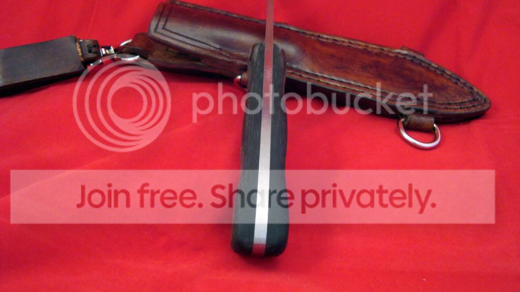

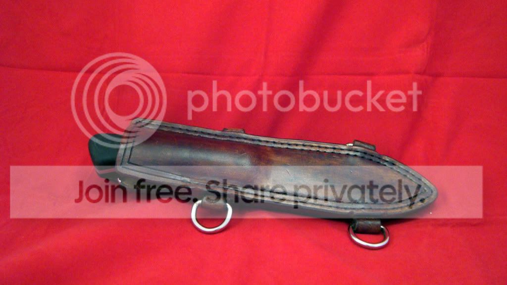

This one is a combination of filing and using the grinder to rough in the handle. I can't remember the exact specs on it other than it is 3/16" O-1 steel HT by knifemaker.ca with a RC of 60. The scales are black linen micarta. The sheath is very plain but the customer wanted multiple carry options so it has a standard belt loop, a dangler loop and 4 D-rings so he can lash it in just about any position. The finish is Timber Brown but he wanted an distressed look so I hit the surface with a bit of 60 grit paper before dying it. The grind is full flat as he requested.
It was also requested that the edge looked a little rough because he likes the rustic look, so I put a few grind marks just above the finished edge
I really admire the Bowie. Excellent work. Are you sure you want change methods?
Yes I am sure I want to switch over to my grinder. I suffer from sever tennis elbow, have had it for going on 3 years now. Had release surgery on the left one back in September and it is no better now then it was before the surgery. The right elbow is almost as bad, so filing out a blade is a long and painful job that takes a couple weeks to recover from.
The Bowie styled one is thick at 13/64" and the second one is 3/16". The reason that one looks like the cutting edge is so high is because the guy that I made it for wanted grind marks above the actual cutting edge. The grind marks aren't really showing up in the pictures though..
