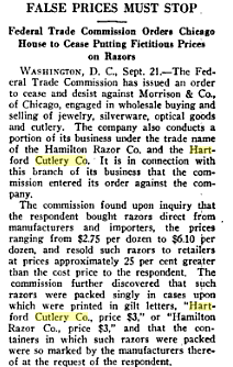

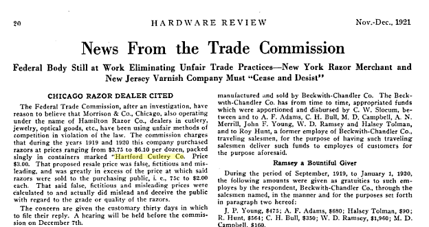

And someone was using the Hartford Cutlery name in a scheme to mislead:
1922 coverage of the same misdeeds says Hartford Cutlery is a DBA for Morrison & Company of Chicago:

Notice that Morrison & Co. also used "Hartford Cutlery."
