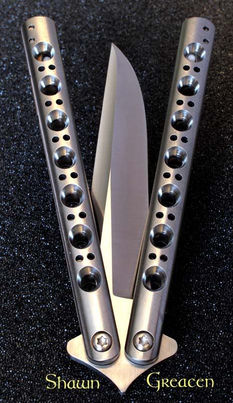

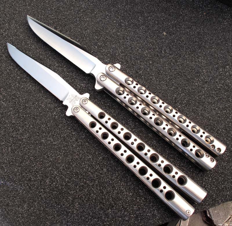

Blade: ATS-34 3/16" Thick
Handles: orangepeeled TI
Spacers: Orangepeeled TI
Benchmade skeleton pattern
IKBS Powered!!

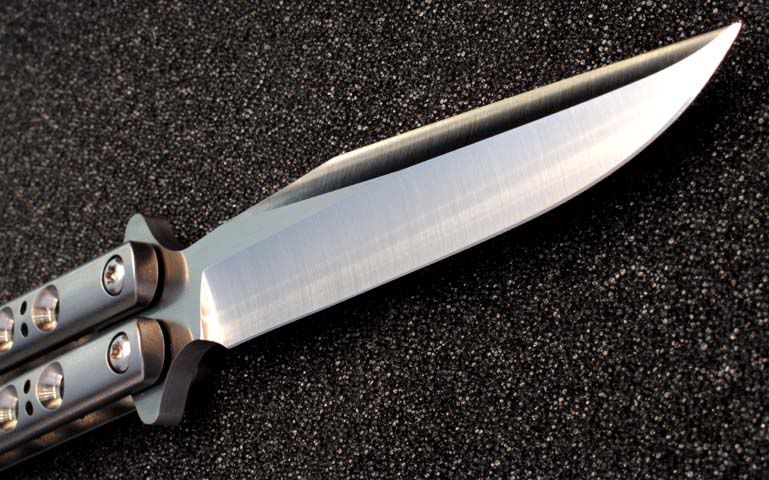

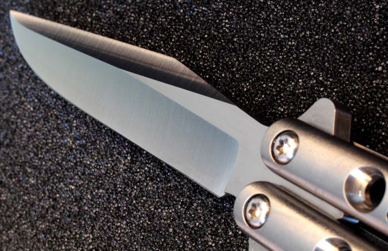

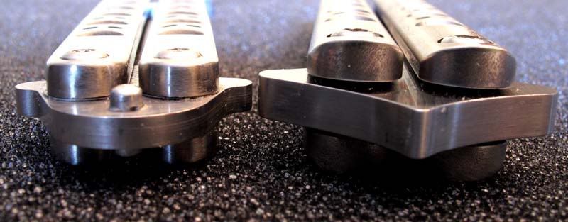

I used a new spacer on the latchless bali,and radiused it on a small wheel which looks pretty cool (imo).i also added a safe handle itentifier.i got the idea from a typhoon our pal Dawkind did wayyy back.i think its great! orabge peel on the entire bali.to date this ones my fav..,something about latchless that just gets me i did my take on a flat clip bowie,you've seen it before.this one just has less belly and is ground on a 3" wheel and swedge on a 1.5" wheel.also made rounded ears..,you'll see more of this!!
