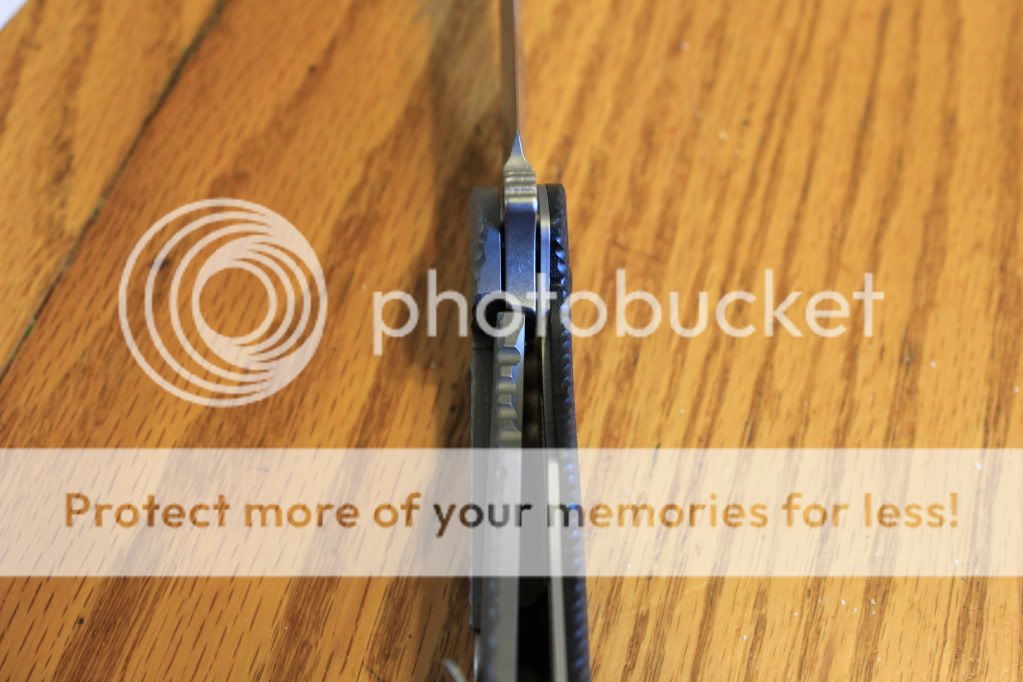

I just received my ZT 560 in the mail. Flipped it out and few times and then inspected it and noticed the lock up seem late, and it was hard to disengage the frame lock. So I checked some picture of the lock up people usually have on here and its seemed around 50% or less. Mine looks more like 60-70%. Is the bad, and is there anything Kershaw will do about it?
Thanks!
Mine was really sticky until i flipped it about 500 times. As long as it locks up tight without any play 60-70% is fine

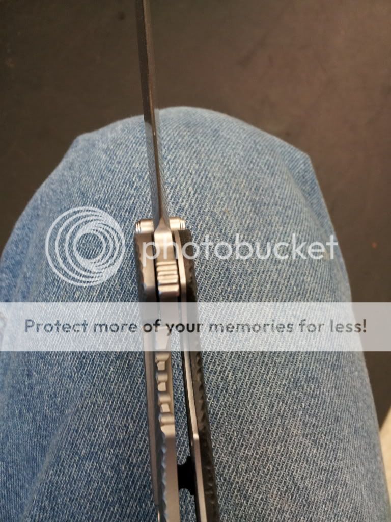

Here's mine for comparison
The later lock up will not hurt your performance and there is no way that I have ever heard of to asses the life of a frame lock no matter if it is late or early. There is also a possibility that a re assembling while pushing the scales in opposite directions may cause the lock to shift to an earlier position.
Well you know that zt will fix for you if it goes to shit. So just use it till you have a problem, which maybe never.

Late lock up is better than early as far as safety is concerned. (harder for it accidentally to disengage) As the others have said, ZT / Kershaw's warranty is among the best in the buisness. I wouldn't worry about the late lock up. I would use that baby like I stole it! ;)

You'rs looks great, heres a picture of mine
A few things that are worth noting: The locking tang of the blade is milled in with and arc ramp rather than a flat angled ramp. The Arc in the ramp will keep your lock from going too far over since it hits a surface that curves upward more than a flat angled ramp can. Your lockup is a little late, but not what I would call unacceptable.
