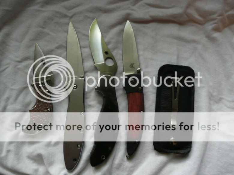

First off, a comparison pic:
(Spyderco Spin, Kershaw Leek, Spyderco Persian, the BM 480, and its sheath)

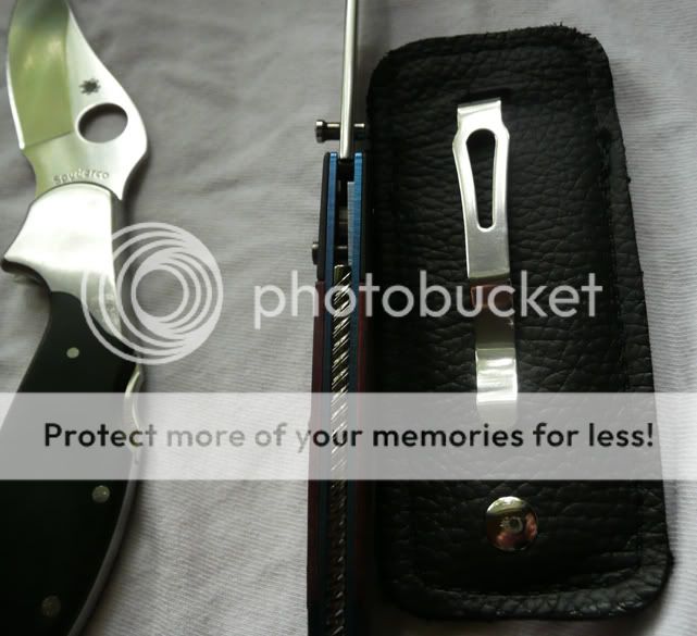

Next we see the upskirt shot :P
Blue anodized titanium, a custom-esque back spacer, and also visible, the locking mechanism.

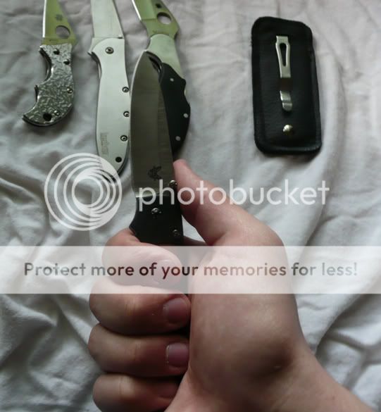

My average sized hands:

I have the BM catalog, but the for some reason the image of the lock internals doesn't make much sense to me. Can you explain it better for me? Nice little knife, BTW.
-Kyle
Taken from the Benchmade forum:
You can see in that picture, how the lock is engaged, just like any other liner lock. Except, that it is hooked, as is the tang of the blade and they catch each other, and it does not allow the blade to go forward (close), and also helps prevent play when opened.
If that doesn't explain I can take some pictures of my own, and show you the hooked tang and all that :)
imagine that the lockbar from a lockback would snap over sideways into the lock cavity, as opposed to dropping in from the top. the backside of the cavity is angled like the lock surface on the tang of a liner/frame lock, and also like the compression lock. If you are familiar with the compression lock, think of this as working similarly - the lockbar of the compression gets compressed between the blade tang and the pin. On the nak-lock, the force is tensile, the blade is stopped by a stop pin, while the engagement of the bar and tang pulls back against it.
