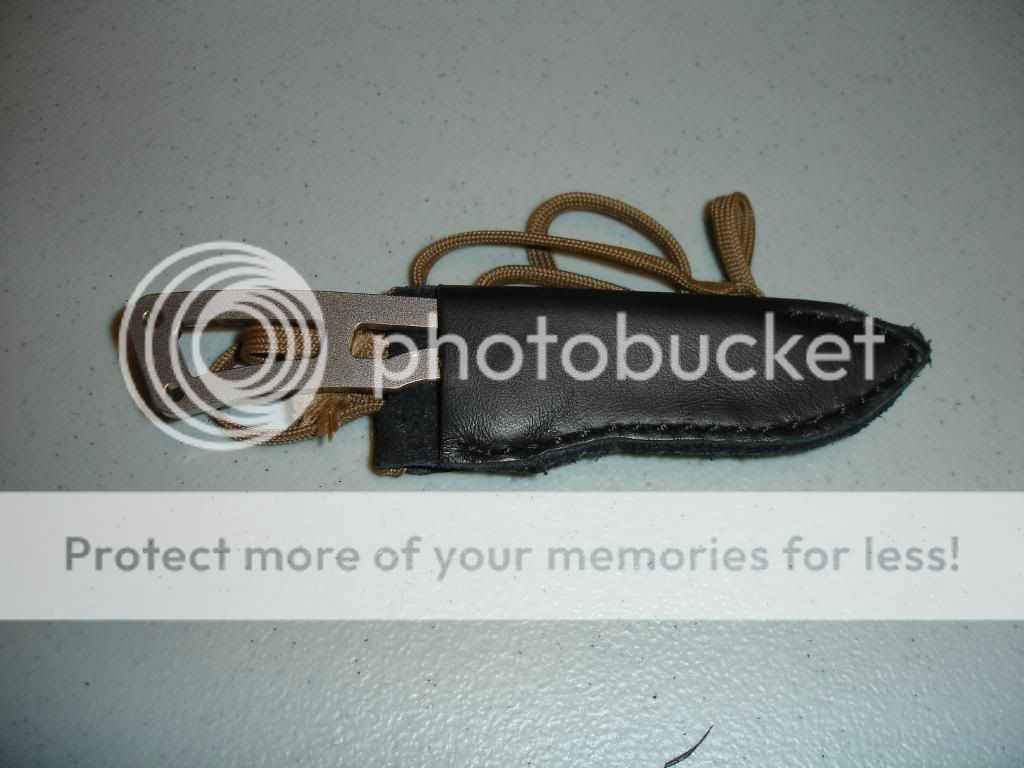

I like the stock sheath that comes with the BK13 but I trimmed it a little bit, and I think that it might have been a bit too much. So I decided to make another sheath for it so I can start carrying it around my neck again. I took my time with this one. I soaked it in warm watter for a bit then pressed it over night to have a good crease in it. Then I sewed it up this morning with all the pieces clamped together.
I like this sheath because I can wear it on my neck or my belt.
I know it's not fancy but I think it's real clean looking, and my wife says that my sewing skills are getting better also. :)

Go around the cut edges with some sandpaper or something and that's a good looking sheath!
I was just thinking about that. I think I will try to sand down the edges on it. Thanks guys.
