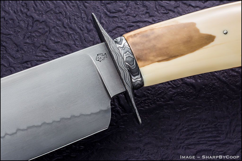

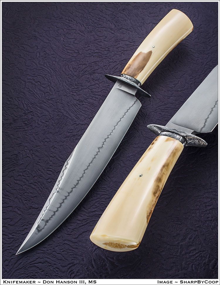

10.75" forged 1086M Blade
Damascus Fittings, Fossil Walrus Handle
16" oal

That 1086M throws out interesting hamons, it seems. Looks like some alloy banding, to boot. :cool:

what size (thickness) would you guess that the stock for the guard was when you started shaping it? 3/8"? 5/16"? somewhere in that range?
I have a couple of bars of Damascus, and I want to grind one and set it up for blanks for bolsters, guards, and butt caps. I was thinking 3/8" would give a good thickness for use to make a good variety.

The damascus stock for the guard was a little less than 1/4" thick. 3/8" stock would give lots of variety.

Real nice turnback on the hamon Don!
