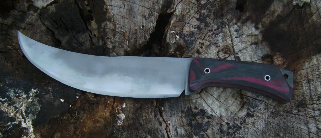

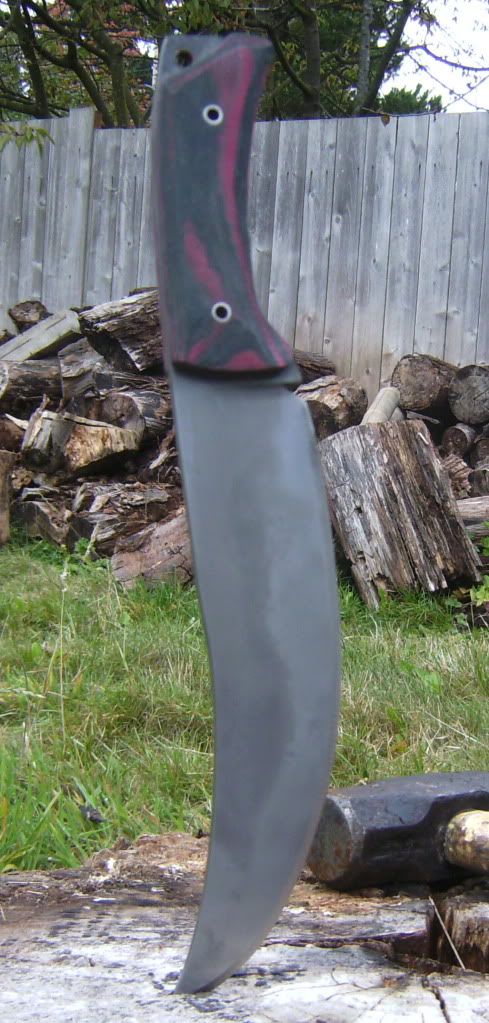

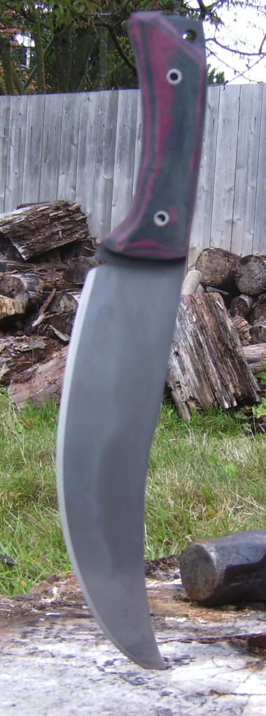

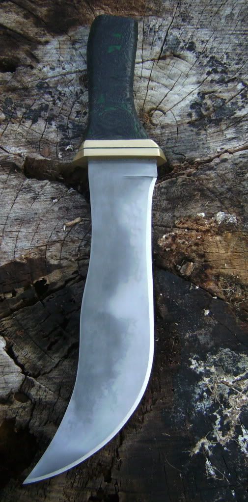

So here is the 1st of my two latest creations. I'll have pics up of #2 sometime today. Tell me what you think, even if you don't like them or see something that seems off!
Thanks for looking!

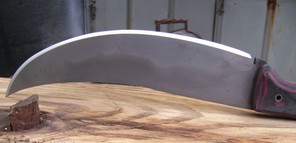

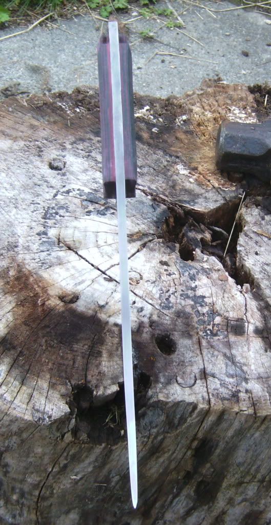

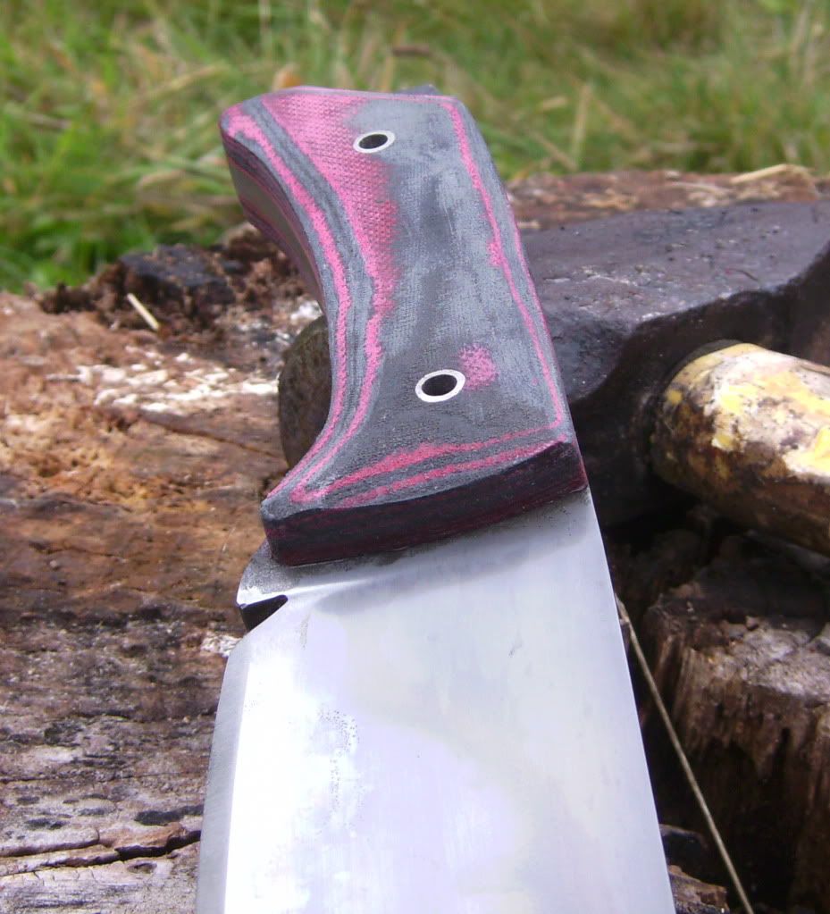

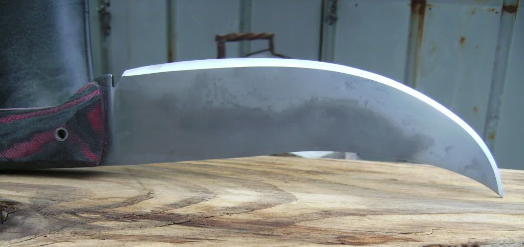

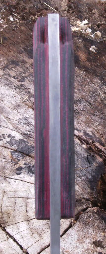

The red and black is a slicer....OAL is 13.5" blade is 8 and 5/8ths tip to scales and 2" at the widest. Handforged 1095 with differential heat treating made obvious by the hamon. Stainless 1/4" tubing instead of pins and home made red and black micarta. The flats with the handles are left as forged.

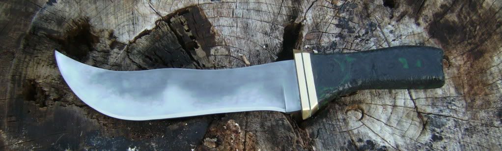

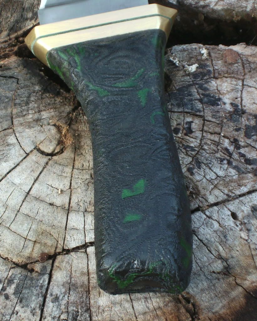

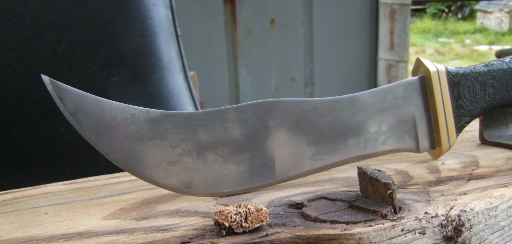

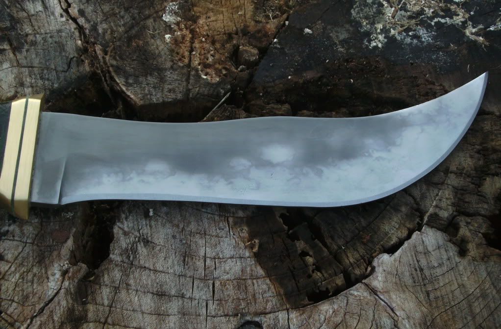

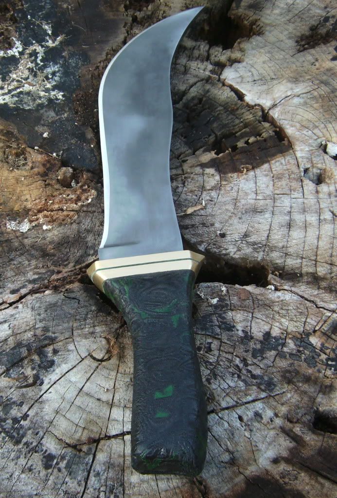

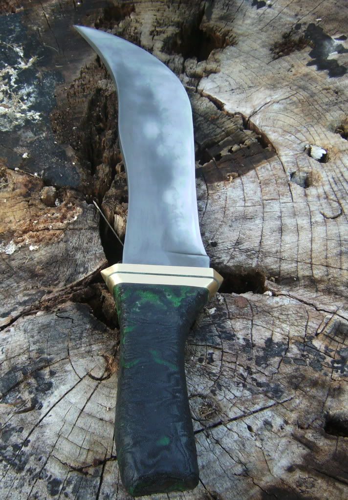

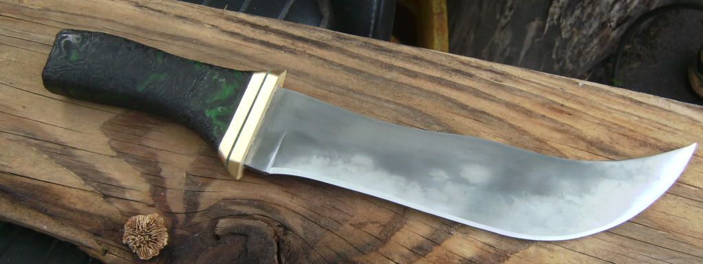

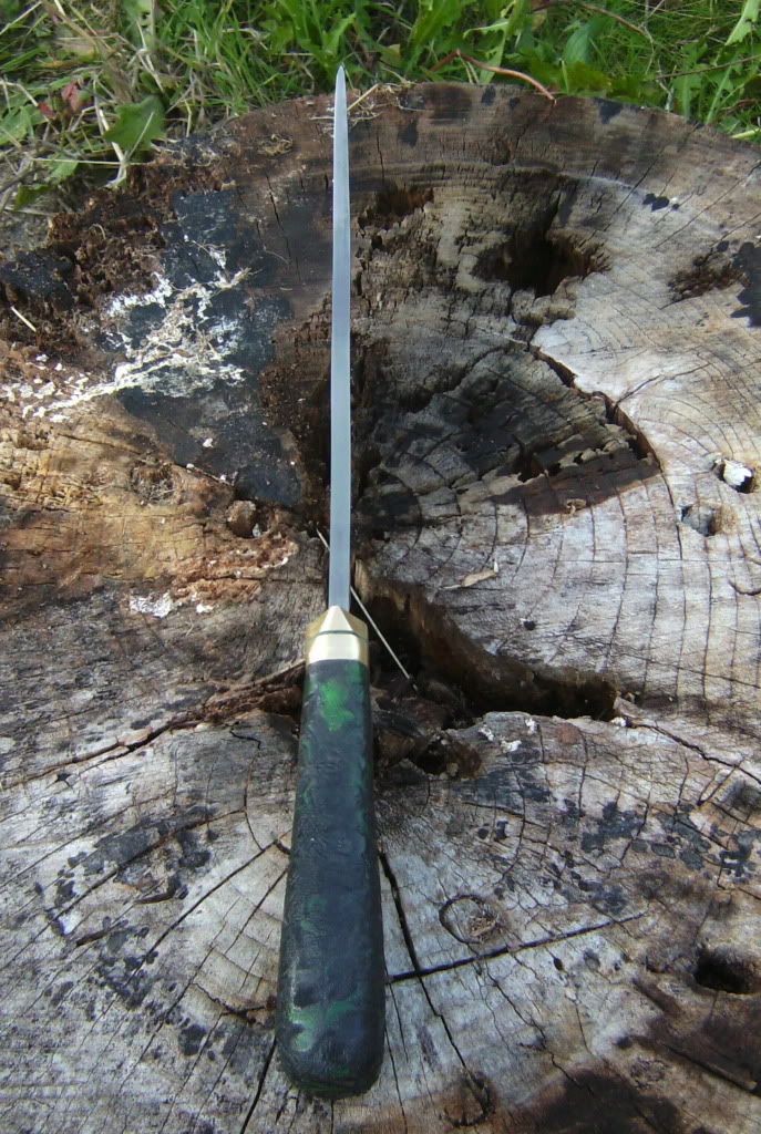

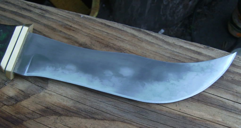

Here is the second....it's a fighter with plenty of chopping/slashing power! Hand forged 1095 with a hamon, brass guard and home made green and black micarta on a hidden tang. OAL is 14.25" with 8 & 7/8ths tip to guard.
