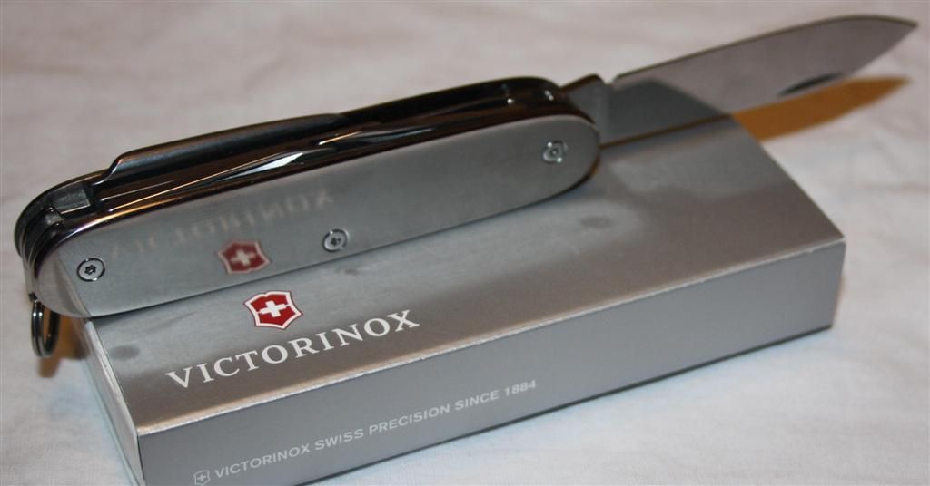

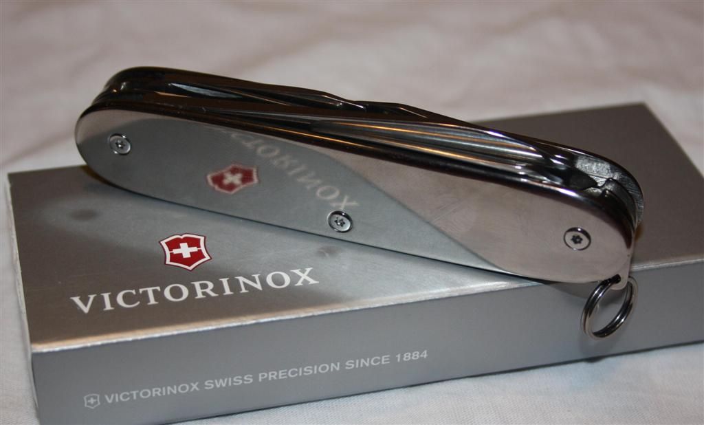

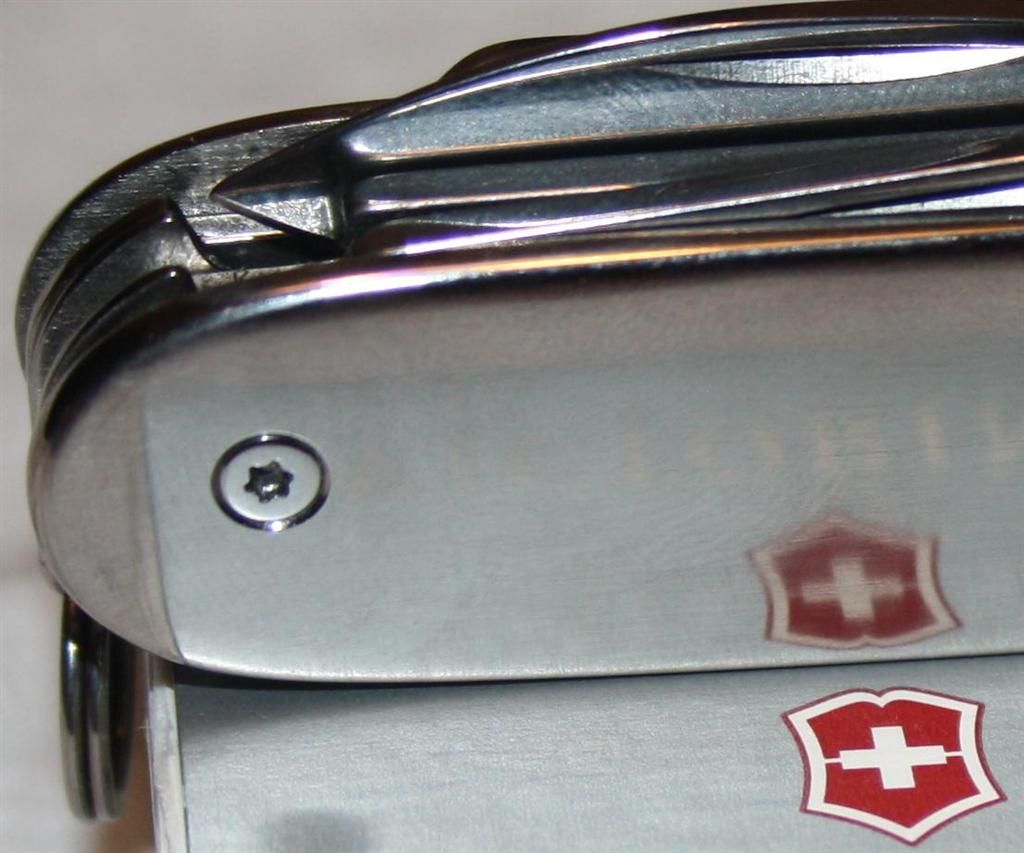

Well I have no fingerprints left from all the sanding, but I got this bad boy put together tonight.
The scales, liners and keyring nub are all made from Titanium (Ti6Al4V) and all hand finished. The liners I had waterjet, the keying liner was laser cut, and the scales cut by hand. I was trying out different methods for cutting the Ti, and waterjet was the way to go. The laser cut had some slag left behind.
It looks like a SAK from the future...
Cheers
