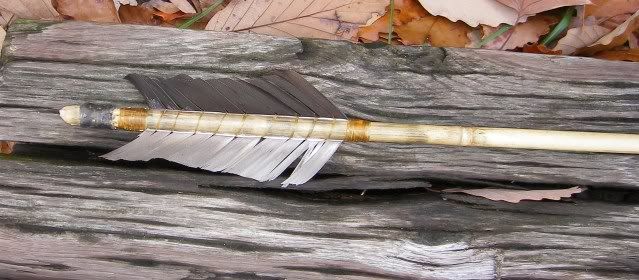

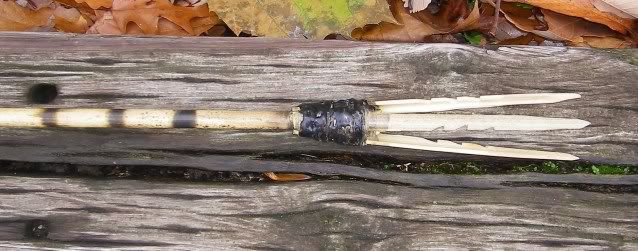

I just finished an arrow that is designed for shooting panfish and eels in shallow water. The shaft and points are bamboo. The points are wrapped and then held with pitch. The fletching is right wing crow primaries (my new favorite fletch) and is tied on with artificial sinew.

What criteria do you use to determine favorite fletch?
I think its universally accepted that turkey feathers are the best fletching to be found. Goose pointers are slightly less durable but their natural oils make them more efficient for wet weather hunting. Both of these are superior to the traditional archer.
I'm mainly a primitive archer, not a trad guy
I have been using crow off and on for a couple years. One of the things I like is to make thing out of materials that I get with primitive means. I have not been able to take a turkey by self bow yet, will try again in March when the season here opens again, but I have shot a few crows with my home made equipment.
I have been very surprised at the water resistance of crow feathers. They are about halfway between turkey and goose in terms of water repelling.
They are easier to split with a knife than goose feathers because they have a divided quill like a turkey.
They are less durable than either turkey or goose but not by much. They are more durable than hawk raptor feathers, which can only be in your possession if you are a falconer.
I think that when harvesting birds by primitive means for fletching feathers the crow is a nice choice for its abundance, long hunting season, and flexibility in ways to legally take the game.
The biggest down side to crow feathers is that you only get six per wing that are suitable for fletching.
Hope that answers your question.
I use right wing feathers and my hunting buddy always uses left wing so we share every bird we get.
