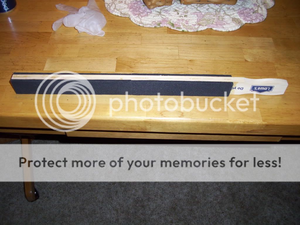

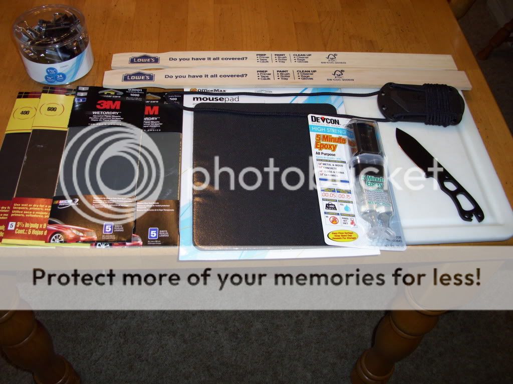

So, i was bored & though i would see just what this stropping thing/convex edge is all about. Here is what i did.

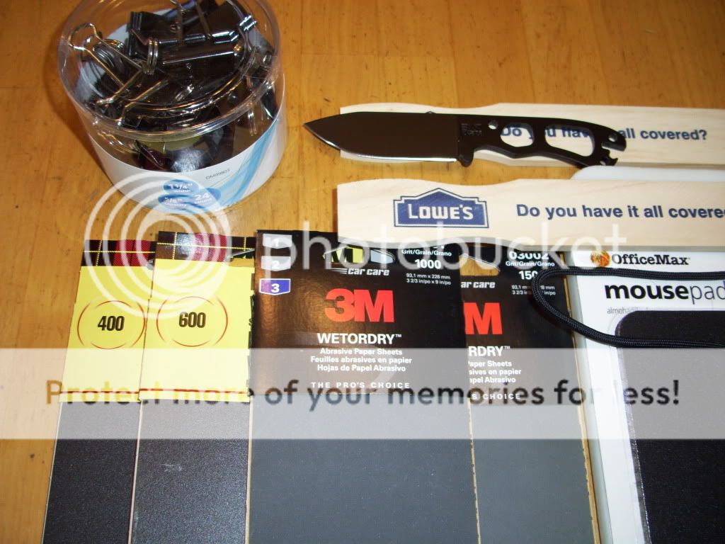

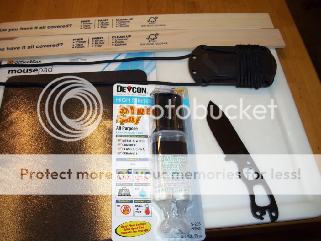

Went to the hardware store, auto parts store & office supply store.
I picked up a few things as you can see. The HD thick paint sticks were free, 400/600/1000/1500 grit sand paper, epoxy, mouse pad, metal spring clips (to hold paper to pad while stropping---should have got bigger ones)

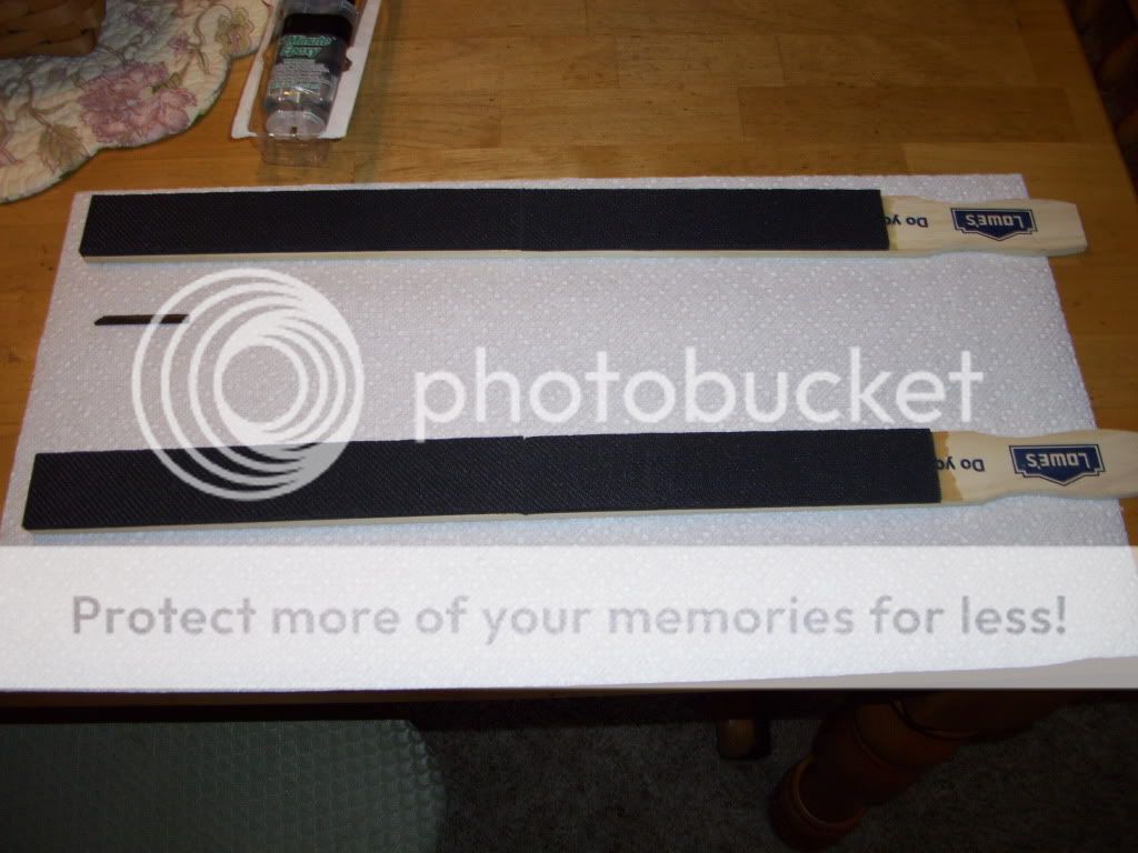

I cut the mouse pad with my Becker BK13 to fit the paint sticks & epoxied them on.
Then i epoxied them together. I did'nt plan to originally, but one just seemed too thin. I wanted to be able to do this while sitting down &/or watching tv, without slicing my leg, & also wanted to make it somewhat field portable when vehicle camping.
So, when i was done, i sharpened my BK2 for 2 hrs. It made it MUCH duller than i had it with my Gatco set at 25 degrees. IDK WTH i am doing wrong. I have watched a LOT of stropping videos. Am i starting with too fine a grit (400)? I ended up using the Gatco again, set at 25 deg, it shaves paper again, easily. Any thought or tips ???

I can't say for certain, but looking at that mouse pad, it looks to be WAY too soft for what you are doing. Might just be the pic, but it looks like foam instead of neoprene.
The side i glued to the sticks was a shiny cloth. It does seem like some type of firm foam, IDK for sure. Any help is appreciated.
Yeah, that is your problem then. That foam isn't near dense enough for what you are after. Neoprene or leather is the way to go. If you got an old leather belt that would work great. I made one darn near identical last week and it has everything crazy sharp.
