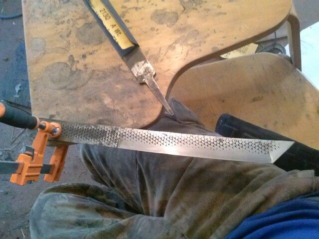

working on this one for my grandpa. made from a hoof rasp. Need a bit of practice getting my "tanto line"? straighter but i like it
