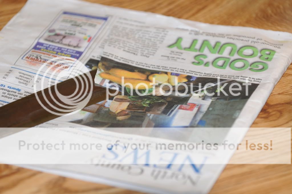

Well, I'm on cheezy knife #2 with my Harbor Freight 1x30 belt sander. I'm starting to get it. Starting.
The first knife - disaster when I realized on my 3rd belt (9 micron) that I didn't take back one side of the blade enough and I still had some of the original grind left. Obviously it never got sharp.
Tried again tonight with blade #2. I took my time with the 320 belt to get rid of all of the original line and get a burr on the opposing side. Then I went to the next grit. Then the next. Then threw the leather strap on. (Leather strap on??? LOL) I had to finish it by hand a bit on a scrap of leather to remove the remainder of the burr.
Then it popped hairs right off my fleepin arm!!!!

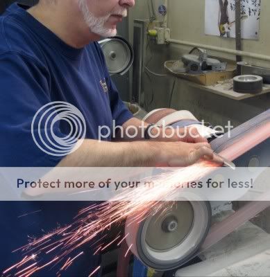

Another thing worthy to consider is tool height, tool orientation and belt direction.
I started out learning on a Delta 1"x30" (similar to the HF). I ground with the tool on it's base belt direction down and edge down for a long time.
But, Mike Stewart swears by grinding edge into the belt. IMO - I think this works VERY well on grits about 220 and coarser and primarily when doing significant blade shaping and re-profiling. But, you DO need to know what you are doing. So, I personally only recommend this technique after having some decent experience with edge NOT grinding into belt direction.
You have to maintain proper angle, proper blade "touch" to the belt and not have frayed belts.
If you do this technique wrong, the most common issue is cutting your belt - which happens pretty quickly and sometimes a bit violently = very unsettling.
I always make sure I hold my blades pretty securely and have never had a blade pulled out of my hand. I don't think belts are so highly prone to grab a blade and yank it from your hand. But, it does seem very feasible.
For me, when I have had belts cut, I believe it has been because I tilted the edge of the blade into the sides of a worn belt. The sharp edge catches a corner and slices through it in a VERY fast instant. So, putting the blade to the belt at the right angle is important - if grinding into the direction of the belt.
But, putting the blade to the belt at the right angle to begin each pass is also important to help avoid making marks that you don't want on parts of the blade where you don't want bad marks. :thumbup:
The coarser grits and stiffer belts seem to keep the blade riding above the grits.
But, once I go to finer grits or more flexible belts, I don't cut into the belt direction any more.
***** Never grind/cut into the direction of a LEATHER belt!!!!! A leather belt WILL grab the edge and WILL yank the knife out of your hand and won't easily slice through.
**** Also, From everything I have read, the BUFFER is VERY DANGEROUS and VERY prone to grabbing a blade and yanking out of your hand. Buffers have been the cause of MANY (possibly MOST) serious accidents in the knife-making world. So, I tend to avoid buffers and don't recommend them for sharpening. Buffers are designed for polishing anyway. NOT sharpening. I am sure with the right buffing wheel and some practice you could polish an edge well. But, I think there are better and safer ways if you use the right equipment.
If you do it right, grinding edge into the belt allows you to see what you are grinding better. .... especially if you have the tool oriented more ideally.
The 1"x30" grinders are not designed for knife-makers. They are designed for wood-working and simple steel grinding. And the design works fine for that.
I have tried a few different tool orientations and belt directions to see what provides optimum results (for me). I can't say what is best for others.
But, this is a pic of Mike Stewart grinding edge into belt:
The belt tool height is ideal IMO. The angle of the tool/belt is ideal:
- you can easily hold the knife across the belt,
- the orientation is good for helping maintain proper blade angle/orientation, I like one hand to hold the handle and the other hand to guide the blade (the above orientation is better for me - allows better control),
- you see what you are doing as well as possible and
- sparks fly behind and away.
Ideally, you learn to switch hands and move the knife across the belt in right to left and left to right motions for each side.
