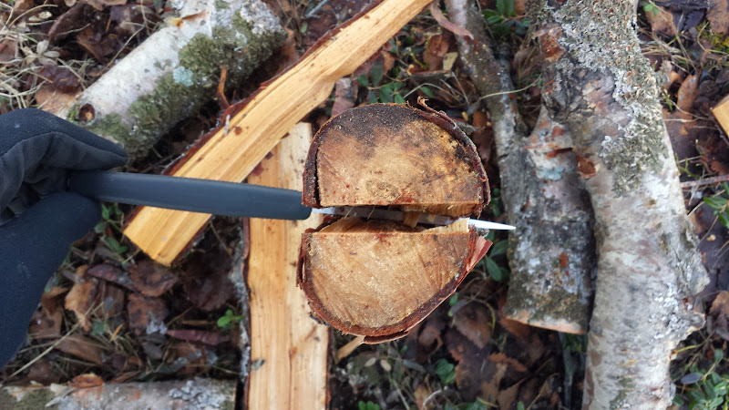

This evening I decided to set things straight. I took her out on a stroll in the romantic end of the woods, just to see if would could get a spark going. This time for real. I brought my Fällkniven F1 and my trusted Bacho Laplander folding saw along on the ride.
Trying to find some good firewood in my neighborhood is difficult to say the least. I live in the arctic part of Norway, closer to the north pole than to the capital. And only birch grows in any serious numbers up here, and they are usually few and far between. And birch doesn't dry up, cause of their bark they rot where they die.
What I got to work with.
My best bet for lighting a spark with my crappy fire steel skills.
I love batoning.
The finished result. I realized quite quick that the wood was damp at best, but that's how it is in this part of the world, especially in this part of the year, with snow and rain and all that jazz. But my birch bark was dry, so I tried to light a fire regardless of the wood.
I had high hopes.
And I managed to get the bark burning! It took some time, perhaps 10 minutes with testing angles, striking the steel or pulling the rod. After a lot of testing and trying I managed to discover what worked best with my equipment. I'm a beginner when it comes to using this kind of gear, but I'm enjoying it, even though a match would probably be faster. Maybe speed also comes with experience?

Good on you. Next time, take some of the Birch bark and shred it up really fine (think wispy pieces) and maybe scrape some of the bark in the middle of this and it should catch the spark much easier.

fire making depends on preparation
baton longer thinner sticks
lots of them
make feather sticks from them
light the feather sticks from the birch
the thin sticks from the feather sticks
three levels
tinder birch
kindling feather sticks
fuel thin batoned
the fire steel ignites the tinder
etc

Nice job and lots of good of advice. Will add that the scraper used with the firesteel is worth about 25% of the equation. Hacksaw blades, SAK awls, sharply angled knife spines, etc. can make a difference too with marginal materials.
