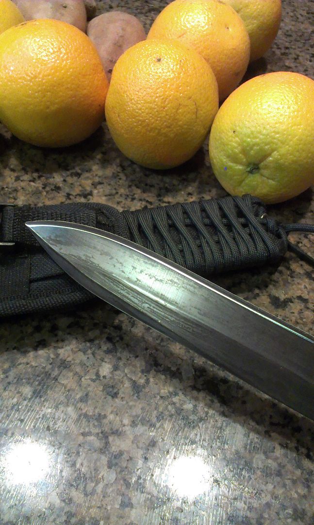

Backing up two seconds... I was bored and decided to take my SCHF1 out and inspect the edge that I had put on it. It came with a hideously obtuse bevel which I spent a year knocking back with a 120 grit Edge Pro stone. Looking at it I wasn't happy at all. I mean, yes it would do the job, but it was far from pretty.
So since I've been toying with my 1x30 for the last week or so I decided to apply what I've learned and try completely reprofiling this blade. It's a pretty thick and long blade, a pretty tedious job by hand.
So out I went with a large container of water for cooling and good intentions.

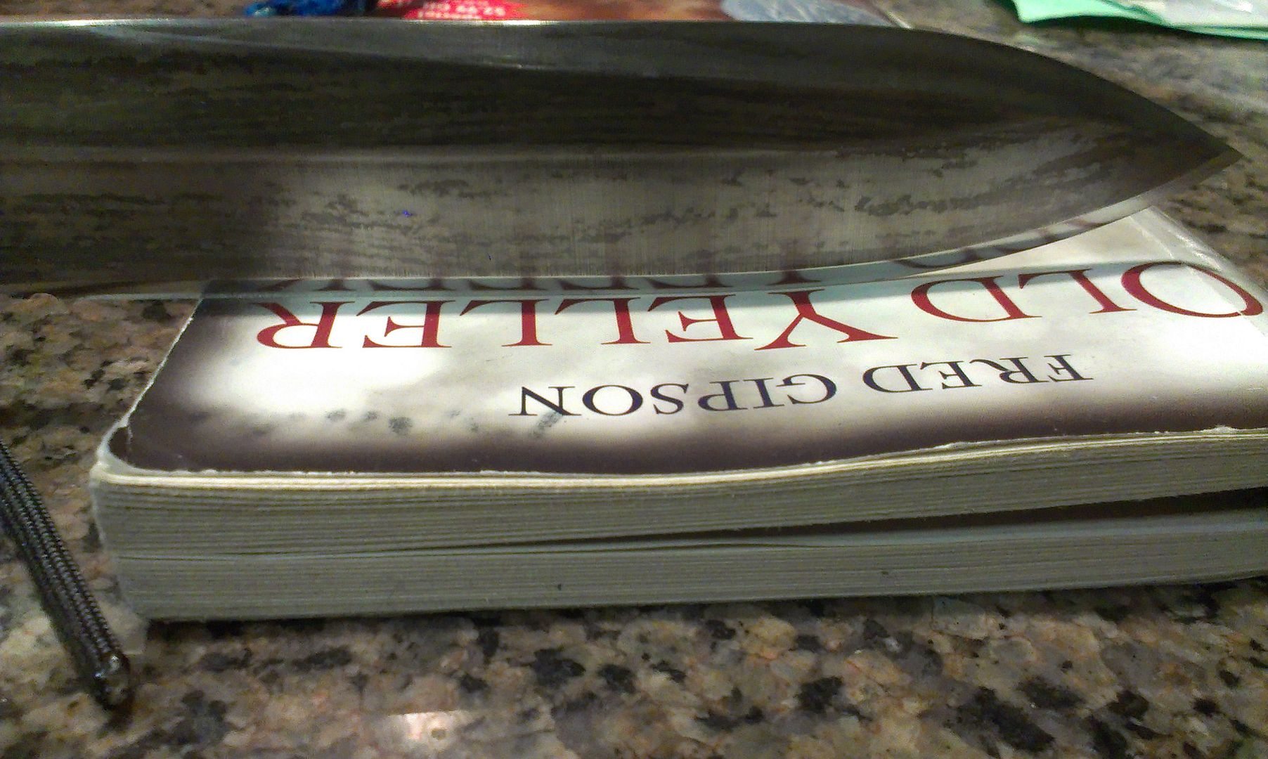

The equipment was the previously mentioned 1x30 Delta belt grinder with a worn 220 grit belt and steady hands. Method was, edge down, about 1/2" above the platen, making certain that nothing ever got hot, and never running the tip more than half way across the belt.
I tried really hard to get some decent pics, but I couldn't find any light that made the edge look right. :(
I'll post what pics I DO have, but let me tell you, the edge is easily one of the better ones I've ever created.
It's sooo easy to develop a perfect full length burr. I've never been able to do it this well in any other instance. You can kind of see the burr in this pic.
Very small, but it runs the whole way down. I used a sharpie while doing this and it was an indispensable tool. An absolute must.
I'm sure you can tell, but if not, I'm very excited about this. The little machine went from knife destroying evil voodoo... thing... - to- Top of the list (interest wise) in my sharpening arsenal.
