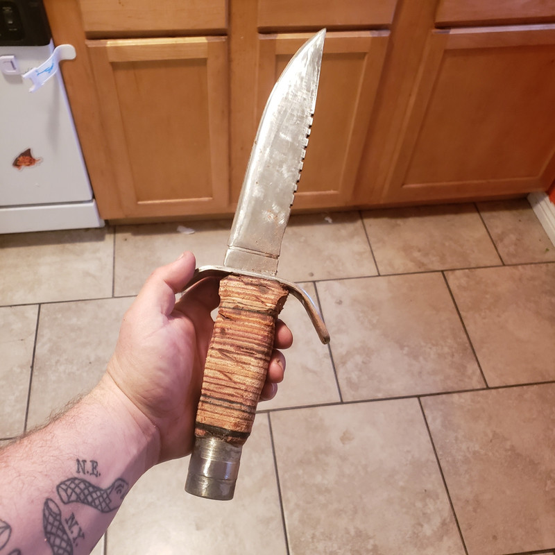

I am at a crucial point with a current project. I have about a inch and a quarter left of leather. As for now its thick and is going to come down to the bottom. I dont want it as small as a k bar milspec type knife.
This is my first ever leather handle. What are some things during the final shaping I should consider? Thanks

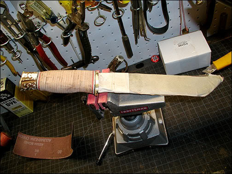

Here's a photo, the bevel is sanded in on the left, and the pencil marks show on the top.
....and finished....
I like to use 80 grit sanding belts on a big file. Secure the top with a "bunny" clip and hold on to the bottom.
Knife in the vice. Gives you plenty of control.
Tape the knife blade and remove it from the vice when you walk away.
A knife in a vice is a dangerous thing, taped or not.

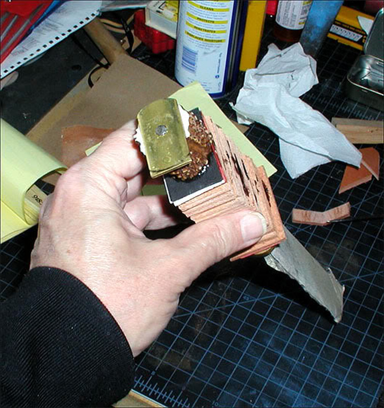

Above after glue up, below after doing the bevel thing and the final smoothing with the old shoe shine method.
If you start with the shoe shine, you lose a lot of control and tend to chase symmetry.... at least I did.
Hope this helps!

Ya I really dont want to expose the tang. I'll start crying lol. I will go with a oval shape that's a great idea
