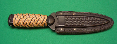

What I'm really after is a laced leather handle wrap like a bull whip.
I think I'm going to buy this book and a couple spools of 6mm kangaroo lacing.
I don't know if this is what you're looking for, but I actually did make a bullwhip (out of paracord) using these sennets. I managed to get it to wrap around the handle shaft and belly. I presume it could be put around a knife handle.
I think what you might be looking for will be found in a recent (week or so...) thread by Tai Goo titled "Recurve Bowie". It even has an animated demo. Good Luck!
