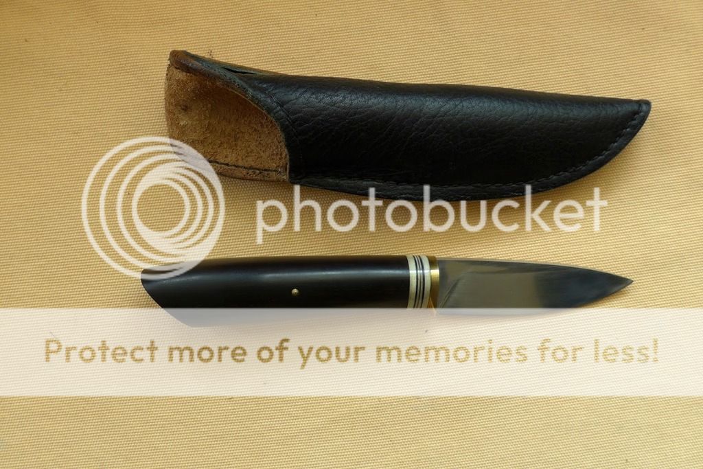

chrome tanned is soft and flexible, like leather jackets.
It doesn't hold shape when you wet form it like vegitable tanned. What you have looks like chrome tanned.
It is good stuff thouh, I use it as a layer over vegetable tanned leather.
You can use leather glue. But rough up the vegetable lanned before glueing. Glue doesn't hold on the smooth side, rough it up well.
I prefer to glue twice before attaching
Here's an example:
vegetable tanned sheath, to hold the knife, chrome tanned on top for the looks
Will the chrome tanned have any negative affect on the knife? I'm thinking some of the leather can be used for making welts and other non-essential parts.

2) Looks like most of that is chrome tan. That would be expected form its uses as boot/shoe/handbag deal. Fkexible leathers are needed for that and that is what chrome tan provides. Looks like you might have a roll of veg tan in that first pic next to the metal canister. Very light (2 oz) veg tan is often used in highend custom boots as a liner and just judging form the pic you might have some of that there. Also used on wallets etc but not so good for sheaths, too light.
3) I feel the dangers of chrome tan against metal have been vastly over stated. I have revolvers in chrome tanned lined holsters that I made, that have lived in those holsters for 10-15 years with no ill effect. They are in the holsters in the safe right now. These are guns that are used on the ranch and they need to be ready to go literally at a moments notice. If you get your leather wet allow it to dry without the gun/knife in it. This is where some of the bad rap comes from I believe. Course that applies to veg tan too.
4) That beeing said I've tried dissimilar leathers for welts and it has not worked out for me. I think your practical uses for most of that lies in either inlays or overlays as Hengelo mentioned. Or as linining leather maybe depending on your sheath style.
