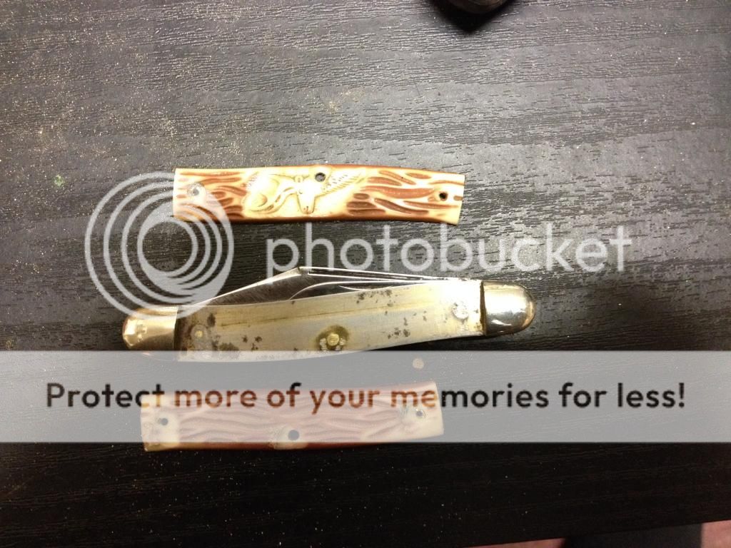

I'm wondering if anyone has tried this. I'm not talking about stacked leather but like on a stockman or slip joint. I was thinking of taking some of my really thick leather and pre dyeing it. Then glueing it on, trimming and shaping. And finishing with wax or possibly super glue. Any one have any ideas?

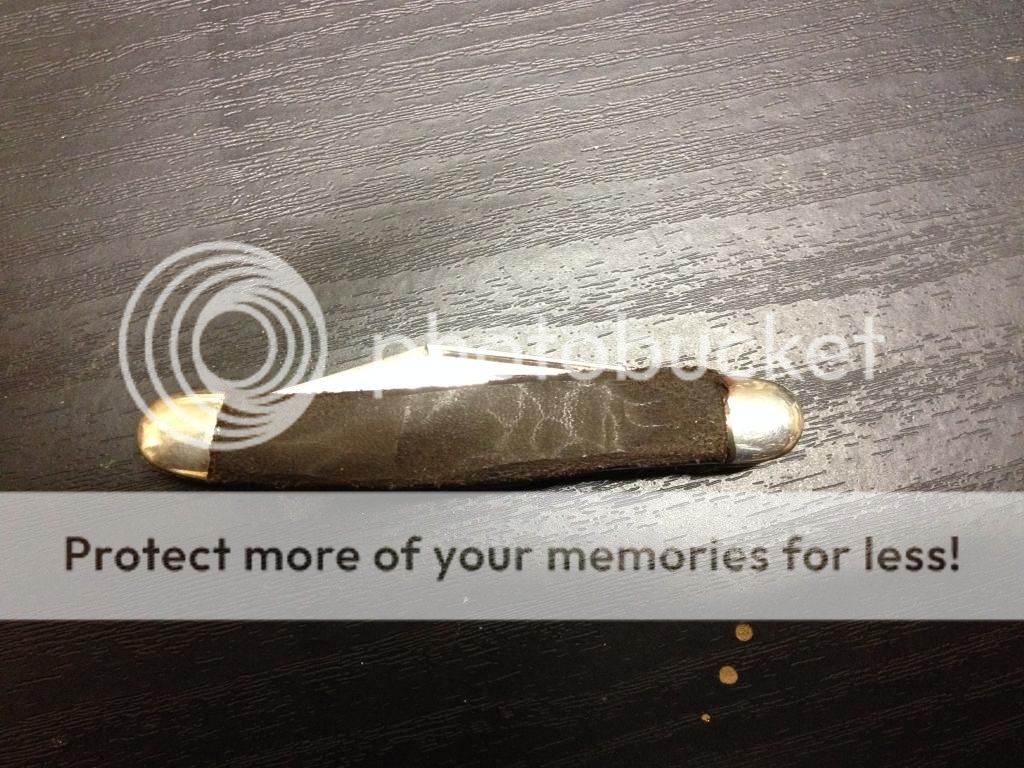

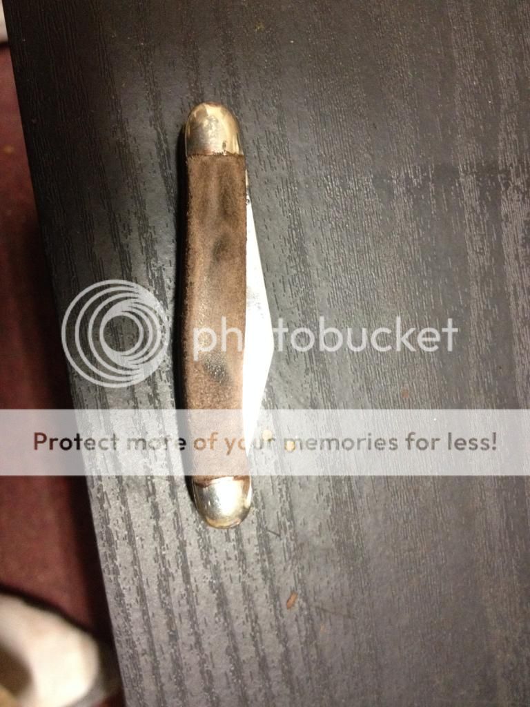

Well, I've started the project. Sorry, I couldn't help myself. I've got the leather glued and trimmed up. I put one coat of dye on but after sanding the leather, I'm going to redye it when I get home. I've got it sanded down fairly well. After the dye dries, I think I'm going with a superglue finish to harden the leather and make it more moisture resistant. And hopefully, I'll be able to sand it smooth and get a nice polish on it
Okay, wife and baby went to bed early so I had a few minutes to continue. I've applied some superglue and did a little bit of wet sanding. There are a few pits in the leather I still need to sand down and maybe some more glue but I'm pretty happy with where this is going.

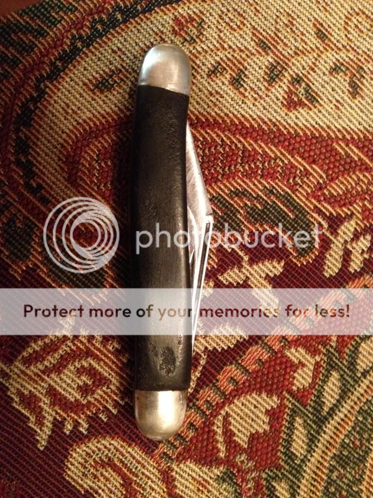

Here it is. I recited with superglue, wet sanded with 220, 600, and 1500 grit sand paper. Then the buffing wheel with green compound on tight stitch wheel then red rouge on soft wheel. Finished up with mothers mag polish. I'm pretty happy wih this little guy now.
Looks great! although, it almost doesn't look like leather, more like some sort of plastic. What does it feel like? Does it have give? or did the superglue just make it as hard as plastic?
that is pretty much how we make our stacked leather customs. if it starts to show ware add ca glue and rebuff. should last a life time or two.
It's held up pretty well. I've lost some of the shine but I'm not terribly worried about that. It may get another buffing today
