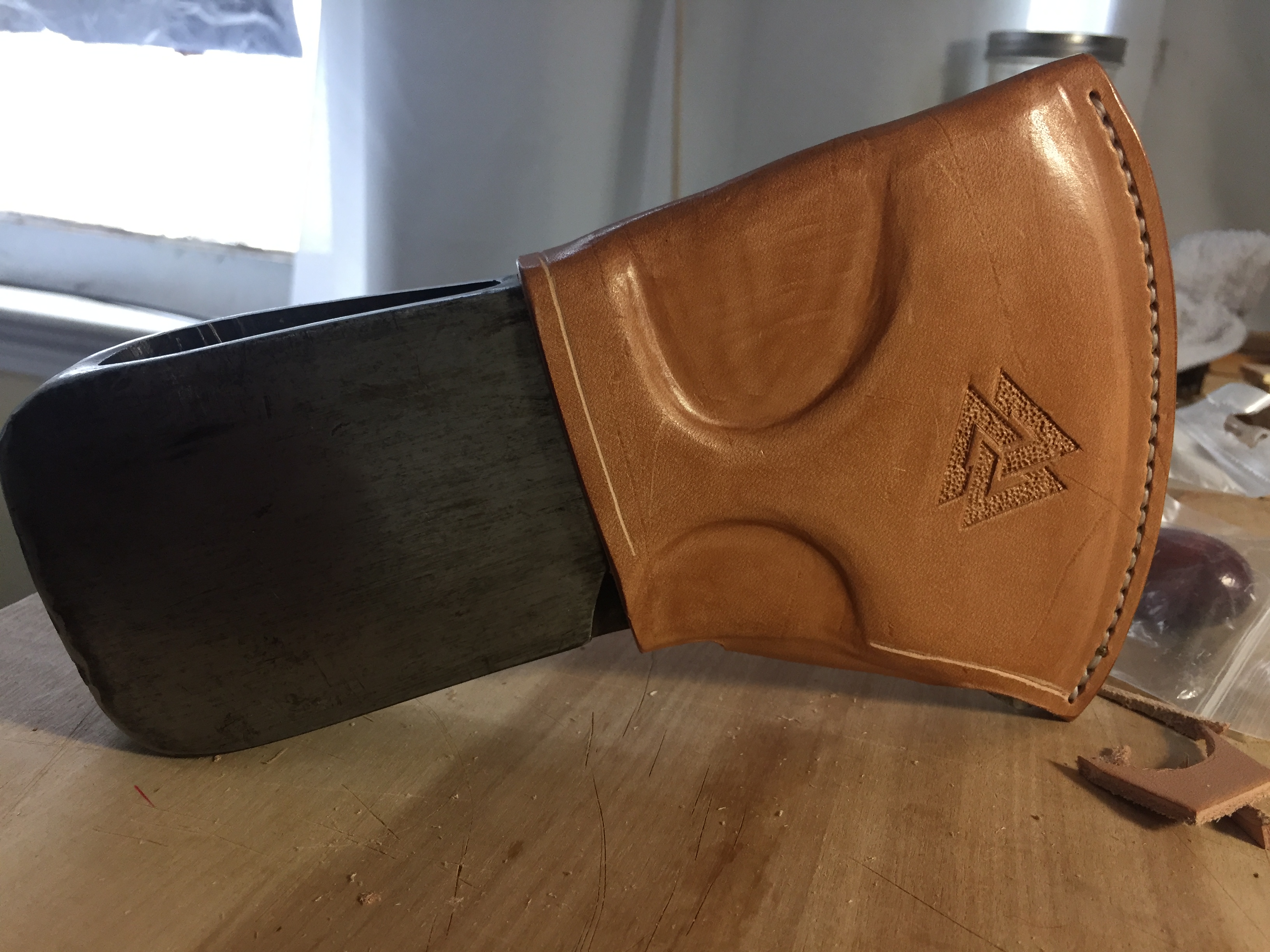

Full grain, if I am not mistaken. There can be some imperfections in the surface. Here is a mask I just finished yesterday from 7/8oz I received last week. This is for an old beater axe that my brother loves. I am rehanging it and and figured why not? But you can see some marks on the surface of the leather that came with the leather (I didn't make all of the marks).
And my apologies to the OP for hijacking his thread.
Gorgeous! Full mark's man!
