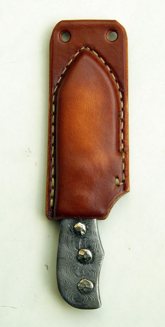

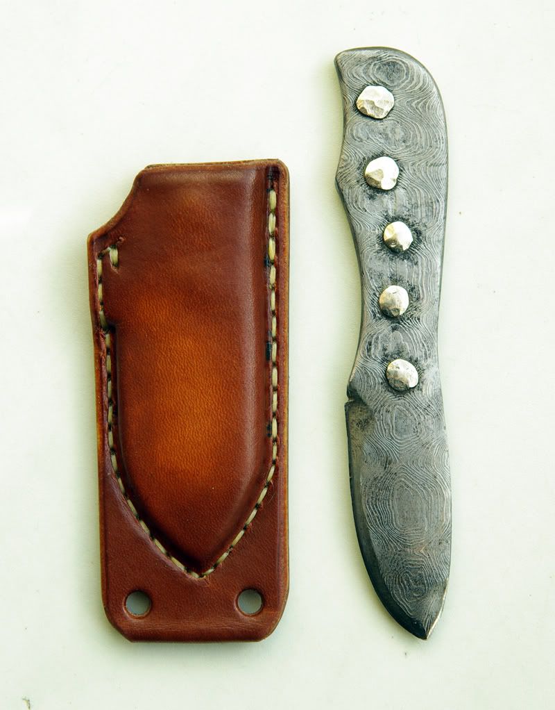

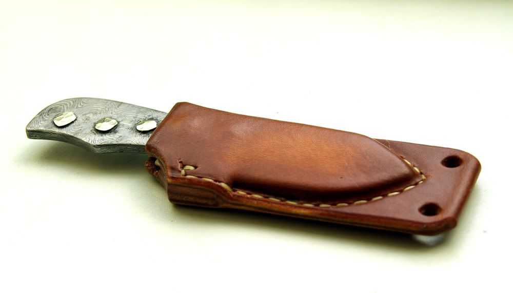

Well, here's my result, I hope you guys like it. I need to finish off the edges but it's done otherwise. I made a double layer back with a plexiglass tab sewn in. I really like the magnet idea since I have some old HDs so I may try it. I have another swick waiting for a sheath. The retention is similar to my Izula with its factory sheath so I feel it's good enough.
Did some more finishing work: (Before and After)
